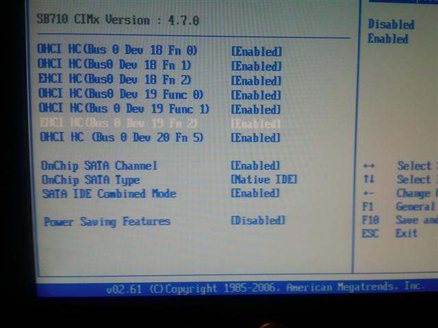

I checked bios and Im not sure what selection to make to turn this into a SATA vs IDE... little help? Screen shot attached.
Reed
The third thing from the bottom. SATA type should not be Native IDE (ie emulate IDE), but AHCI.
Peter
TA880GB + mother board... Found this in the manual (different screen than put up above)
BIOS EHCI Hand-Off
This item allows you to enable support for operating systems without an EHCI
hand-off feature.
Options: Enabled (Default) / Disabled
DO I need to disable the above? or is it...
OnChip SATA Channel
      This option allows you to enable the on-chip Serial ATA.
OnChip SATA Type <-- OR IS IT THIS ONE CHANGE TO AHCI?
            This option allows you to select the on-chip Serial ATA operation mode.
            Options: Native IDE (Default) / RAID / AHCI / Legacy IDE / IDE????AHCI
SATA IDE Combined Mode
            This option controls the SATA/PATA combined mode.
Ok, tried changing to AHCI and it wont boot.. just goes to a hardware monitor... do I need to change something else when I do this? Is this going to mess up my whole drive?
Thanks,
Reed
Ok, changed to AHCI and found that the boot devices changed.. I got it to boot with AHCI, however it is still only showing 4 SATA drives... Is this a limitation of the hard drive? How do I get the 5th drive to show up at SATA?
Any help is appreciated! Sorry for the string, just looking for some help and dont want someone to trouble shoot a issue I already figured out.
Thanks.
Reed
Damn... figured it out... This may be nice for someone else... Gotta turn compatibilitt mode off... that made it work.. thanks pro.
