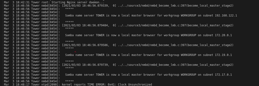

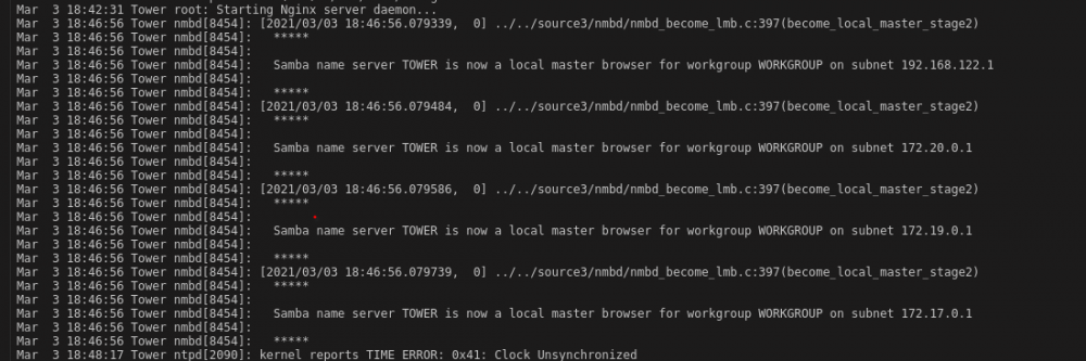

Last several lines of the syslog ......note the last line.
I seem to remember some mention of this in the release notes.....lets go and have a look.

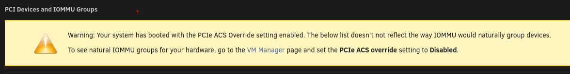

This is done in order to run my PFSense router on my server.
Possible????
