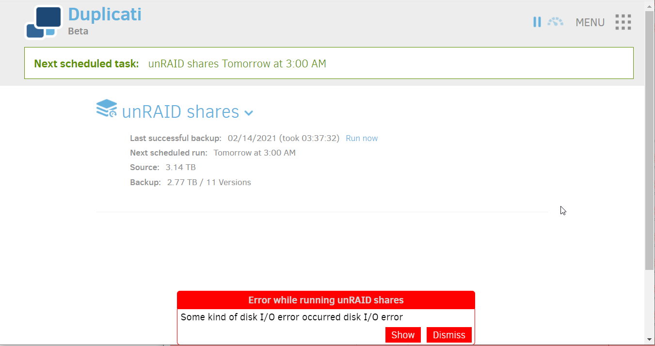

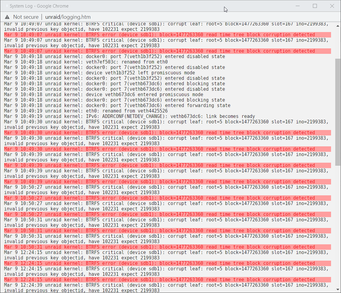

I've set up Duplicati to do a backup of my data and container backup shares every night at 03:00.  Before that I create a local backup of all my containers' appdata folders at 02:00, and deposit the bacup in the forementioned backup share.  This has worked fine for a while, but I noticed now that the backup hasn't run successfully for some weeks.  And today I noticed that I get a BTRFS error in my unRAID system log when trying to run a Duplicati backup process.  In Duplicati I just get an IO disk error without any more information.
Any idea what can be the problem here?  As far as I can tell I'm not trying to backup a folder that doesn't exist anymore or anything like that.  Why would unRAID complain about Duplicati reading the data and backup shares?
There's corruption in the tree block, best bet is to backup and re-format.

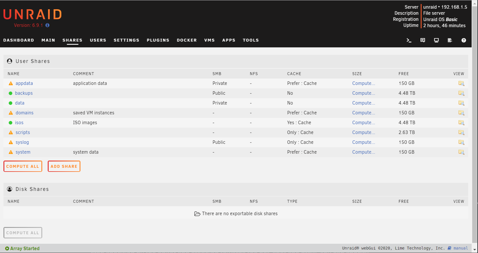

Ugh, yeah, I should have noticed the 'sdb' reference.  I apologize - I am still a fairly new unRAID user.  'sdb' is as you say the cache drive, which is a 128GB SSD I earlier used as a boot drive in the server.  I have some shares that store to the cache drive, as you can see.

Filesystem corruption is most usually caused by an unclean shutdown or hardware problem, like bad RAM.
I've had some unclean shutdowns due to hangs caused by hardware problems (the mainboard USB controller's crapping out on me).  So likely this can be the cause then.
But I read that BTRFS corruption is a well-known problem.  So I've changed the file system on the cache drive to XFS, and am currently rebuilding the Duplicati database.  All is well again, at least so far. 🙂
