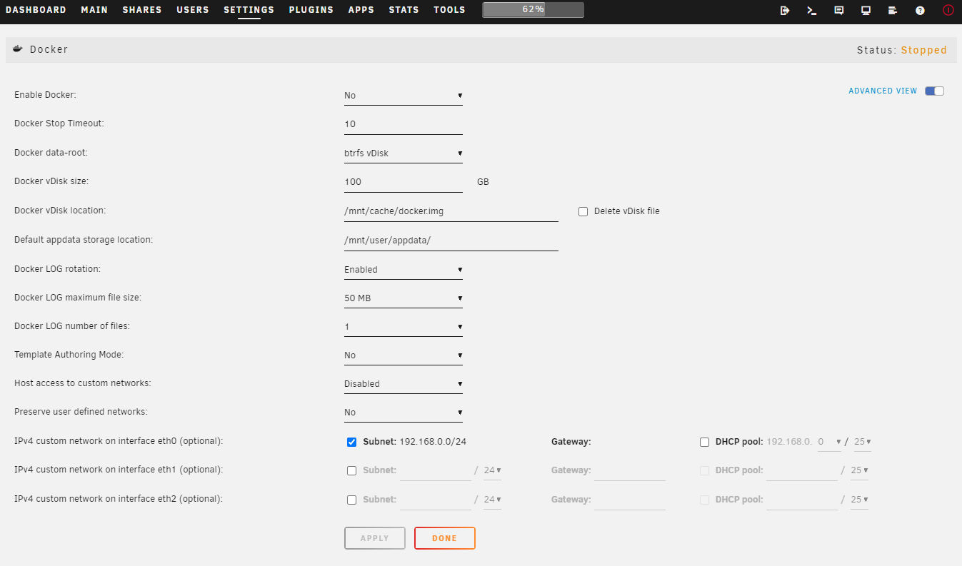

Hm 10gbit is working now but Docker isn't anymore.
the Containers i have are working but i can not add any new ones.
Here an example when i try to install apache:
root@localhost:# /usr/local/emhttp/plugins/dynamix.docker.manager/scripts/docker run -d --name='apache' --net='bridge' -e TZ="Europe/Berlin" -e HOST_OS="Unraid" -e 'PUID'='99' -e 'PGID'='100' -p '80:80/tcp' -p '443:443/tcp' -v '/mnt/user/appdata/apache':'/config':'rw' 'linuxserver/apache'
Unable to find image 'linuxserver/apache:latest' locally
docker: Error response from daemon: Get https://registry-1.docker.io/v2/: dial tcp 23.23.116.141:443: connect: network is unreachable.
See 'docker run --help'.
The command failed.
Any Ideas why this happens?
tower-syslog-20210323-1005.zip
Edited by leech
Found it! :)
Somehow the default route went missing, added 0.0.0.0/0 + GW and now it's working again :)
