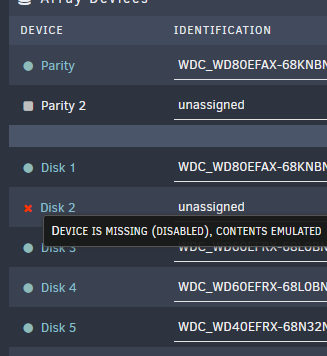

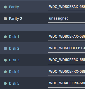

Had a drive (WD RED 6TB) fail, replacement drive arrived today but when i try to set it into the same slot (Disk 2) as the previous drive I get "The replacement disk must be as big or bigger than the original." and can't start the array.
Original Disk: WD RED 6TB (WD60EFRX)
Replacement: WD RED Pro 6TB (WD6003FFBX)

image.png.dfbf094468f31fef03adedf297f1e8d9.pngimage.png.fe88cceb0a2b7cbf20a7f113521a97cb.png

Current 6TB disk is the correct size (for 6TB), but the disk that failed for some reason was larger than normal:
[sizeSb] => 5860765964
This is the normal size for 6TB:
[sizeSb] => 5860522532
You'll need to replace it with an 8TB drive, or manually copy the data and do a new config.
