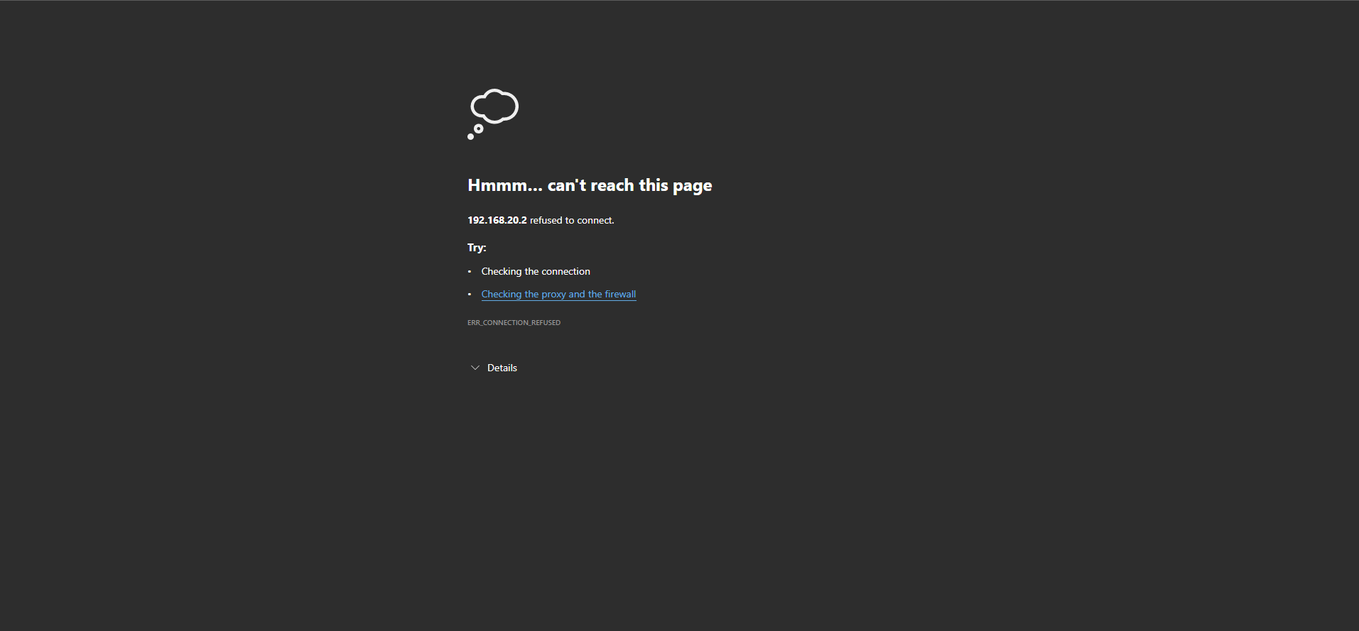

Ok so webgui still unavailable with automount turned off
and again 8 minutes later i can connect haha
