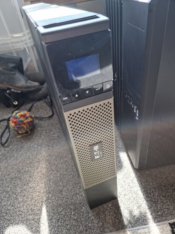

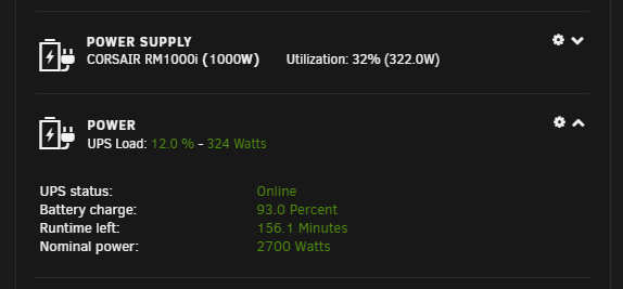

Just upgraded my UPS to a Eaton 5px 3000i with 1x 3000va extra battery module. What a monster! Got a bit of breathing space on the runtime now compared to my cyberpower 780watt 🤪😂

That's pretty slick having the corsair PSU show usage. My EVGA has feature envy
