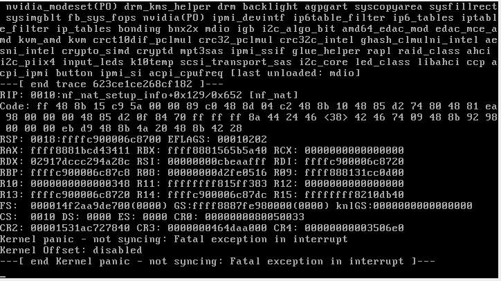

I recently added the old drives from my prior NAS to my new Unraid server, and also added a 2nd parity drive (both parity drives are brand new.) The first time it was doing the parity rebuild, the server crashed with a kernel panic. I rebooted the server, and had to reinstall my docker containers since the docker image broke (I don't remember the specifics, I just remember finding a guide on the forums for how to fix the issue). I started rebuilding the parity this morning, and just had another kernel panic. This time I was able to capture a screen shot from the IPMI shown here:

I had another crash today, this time I was able to get the logs from the syslog server. The 127.0.0.1 log is from the local syslog setting, and the 192.168.1.223 is from the remote syslog server setting. Based on the screenshot from the original crash, I think this might have something to do with the GPU Transcoding in Plex, but I'm not completely sure how to best troubleshoot that. Any assistance would be greatly appreciated.

Have you tried without the nvidia plugin?
Not yet, I was hoping someone with more experience then I have would be able to parse the logs and confirm my suspicions. Since I don't know exactly when the server is crash, or why, I was only guessing about the NVIDIA trans-coding based on the screenshot.
