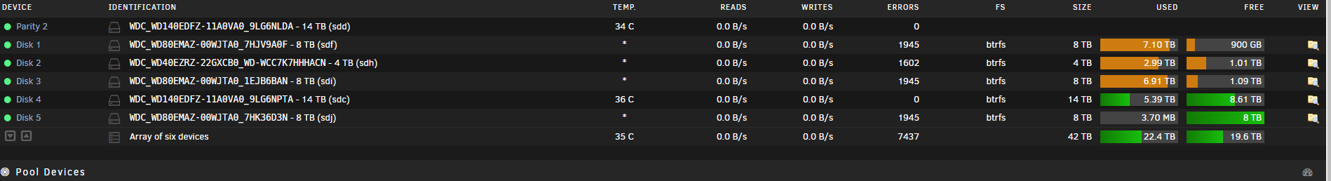

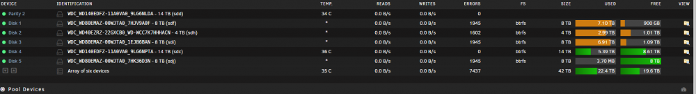

7000+ BTRFS Errors
Unbeknownst to me, over the course of two hrs, my server experienced over 7000 btfs errors. I frankly have very little idea of what happened. I tried to stop the array as soon as I realized what was happening. Unraid after a min threw the "Retry unmounting user share(s)". I then booted into safe mode. I don't know where to go from here. Please help me out. I would greatly appreciate it. My very very long syslog is attached
