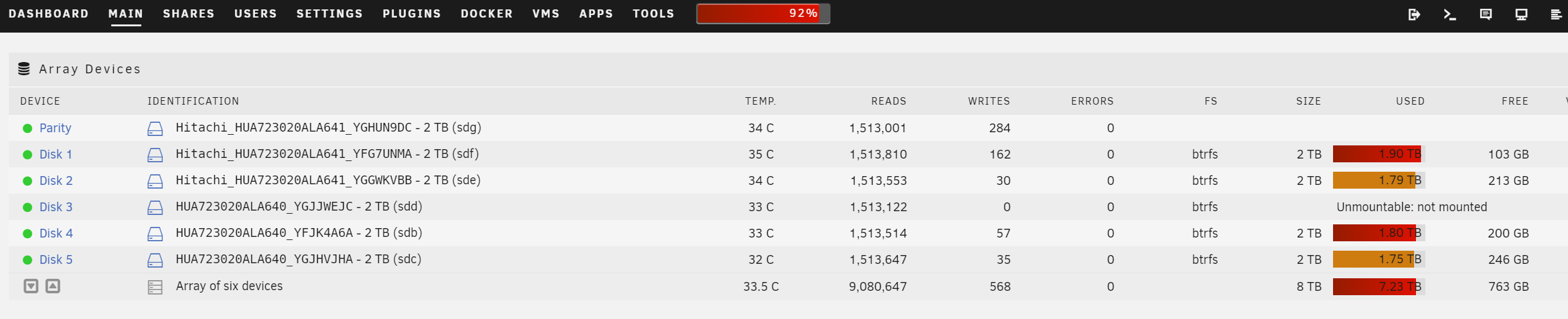

Originally the system was on 6.8.3 running just fine. Haven't had any issues with it lately and had recently ran the parity check. All the drives have been fine. All the drives in the array are btrfs. I upgraded to 6.9.1 & after rebooting disk3 shows as unmountable: not mounted. When looking through the system logs I only seen the below error for md3 or disk3.

Thanks for your insight. I am reading through that article. Didn't want trying things and make it worse.  *Format meaning take it to another system and format it then plug it in like a replacement disk. If a disk is unmountable the data is still intact technically due to parity, right? Meaning if I simulated a failure like unplugging that particular drive that couldn't be mounted. The parity already emulates whats on that drive until a replacement drive gets re-added.

This appears to be the case. I downgraded back to 6.8.3 and the disk came back. With the disk back available I think I should be able to scrub it and find the corruption on the disk and fix it.
