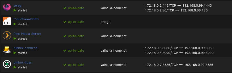

I recently switched over my containers to their own custom network, and all of them are running fine and fully accessible, except the Plex server. I am using the plexinc/Plex-Media-Server. It is showing up as having no IP address. I tried several times to add a fixed IP but it refuses to start if I do that. I literally didn't do anything but change the network type on the other containers and they all work fine, but not this one. Any ideas on what is going on and how to fix it? TIA!

I have a Plex Pass as well. What network type are you using? I tried creating a new container, no luck. I might try one of the other ones and see if that fixes it :(
one is UDP TCP and network is on HOST.
HOST is in the container,
Switched to hotio/plex and it's working fine, weird! Thanks for the help everyone!

If you change from your custom Docker network to Host, do you get an IP then? I seem to remember that Plex's official container suggests running it with Host, but I'm not sure. I know other Docker images doesn't suggest it.
Hello,
Appreciate the follow-up.
To answer your question, yes changing the network to host (default state) does work and is operational. I was pondering adding the plex docker container through a reverse proxy which is on my custom network and was pondering why the IPs were not applying on a custom network.
Based on your feedback, I may have to continue my research to drill down on how to accomplish this.
