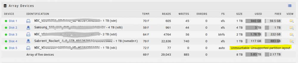

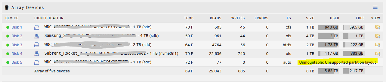

Thank you greatly trurl for the help. Everything looks to be back and has been copied to a separate drive with the exception of one drive which shows up as "Unmountable: Unsupported partition layout".
As previously mentioned these were cloned drives and therefore had data on them so I don't want to PreClear/format it. The original drive was approximately 750gb however when the company cloned it they used a 1tb drive with a smaller partition.
Any further suggestions would be greatly appreciated and thank you again for your valued knowledge and support
hopr-diagnostics-20210414-0448.zip
Do a new config without disk5 and then see if it mounts with the UD plugin, if it doesn't post new diags after a mount attempt.
