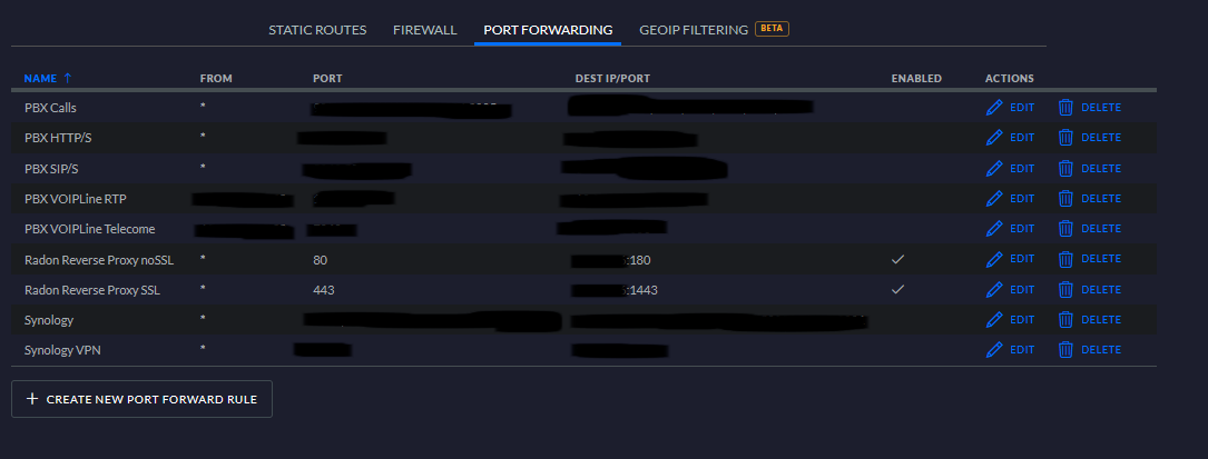

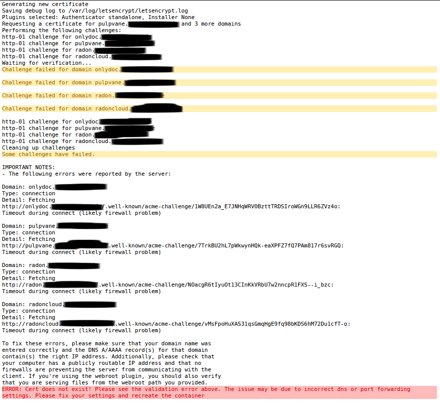

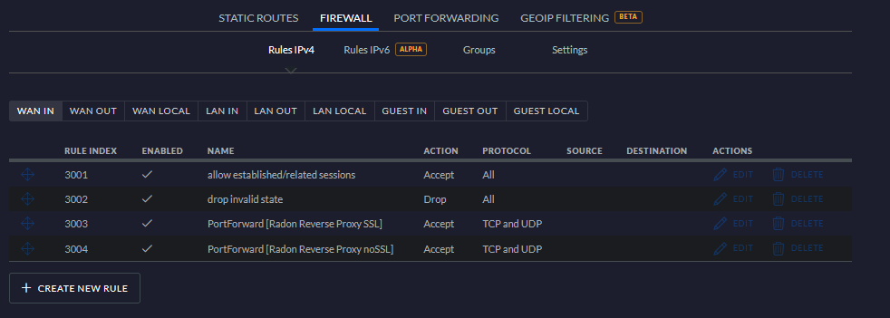

Attached is my firewall settings and port forwarding rules along with the error's being generated by swag. I have redacted the root domain, IP's ect for privacy and security.

The log says that the ssl certs are not being created as it cant verify the subdomains. You are using http verification, so it checks using the subdomain ie radoncloud.yourdomain.com is resolving back to swag through port 80.
So this is not happening. I can see you have set up a port forwarding rule, but some isps block port 80 on home connections. I would suggest moving your domain to cloudflare then using dns verification rather than http

Thanks for the assist. Yes as it turns out my ISP does block port 80 and 443 by default. Good News, It can be disabled easily and it works perfectly now ... sorta. I might have to make a new post about OnlyOffice document server if I can't figure that one out. But Swag has now sorted itself out so thanks a heap!
