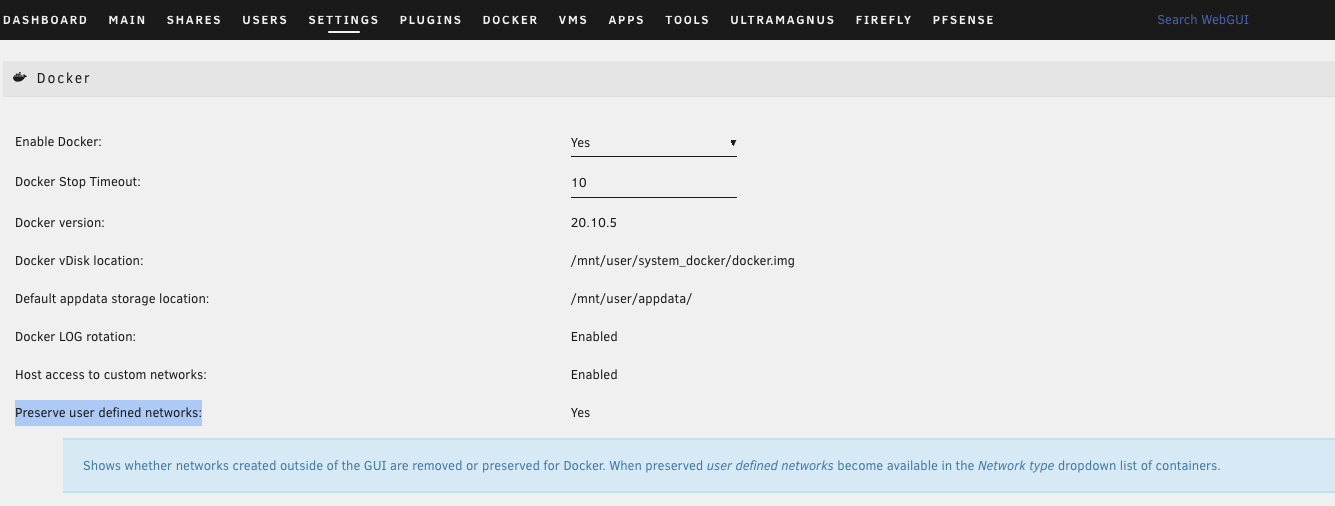

Make sure that on settings/docker/    that you have preserve user defined networks.   (you will need to stop the docker service to change this setting)

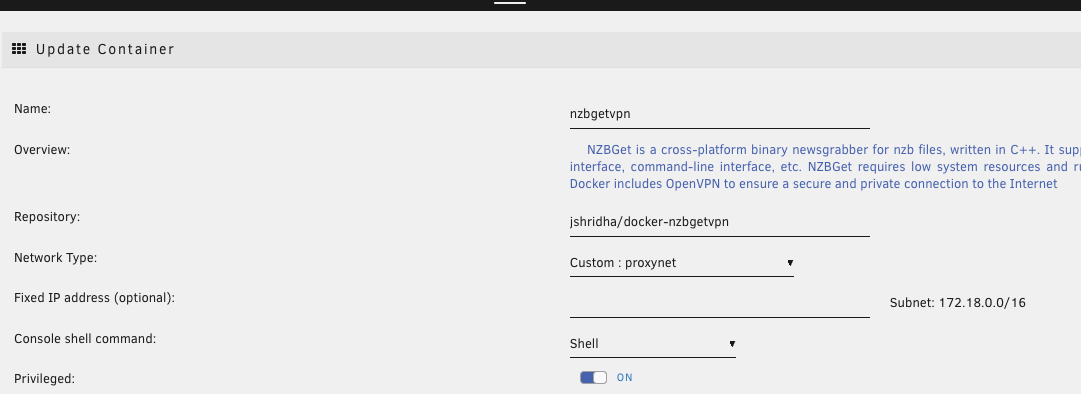

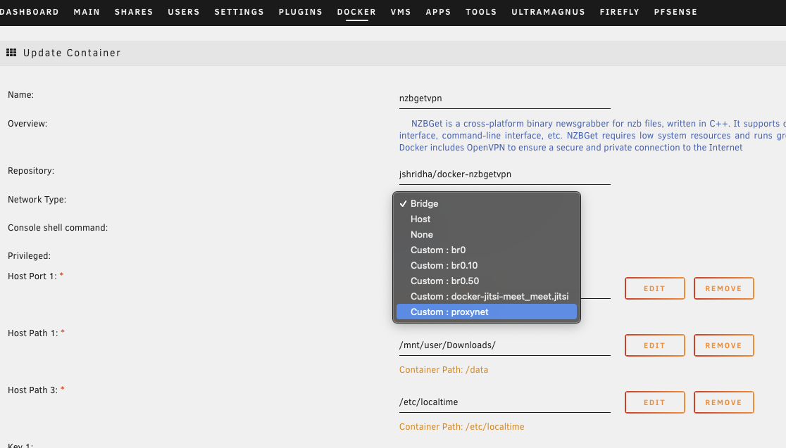

Now you must change  nzbget, sonarr radarr and any other containers that connect to nzbget to use this network.
So goto the docker template and change the network type to the type you created above.
1379912150_Screenshot2021-04-17at07_24_15.thumb.png.5186077af385be14d28888d01a8fd11a.png
780562896_Screenshot2021-04-17at07_24_27.thumb.png.6466b4393a9d07edb2eea6e50124d42b.png

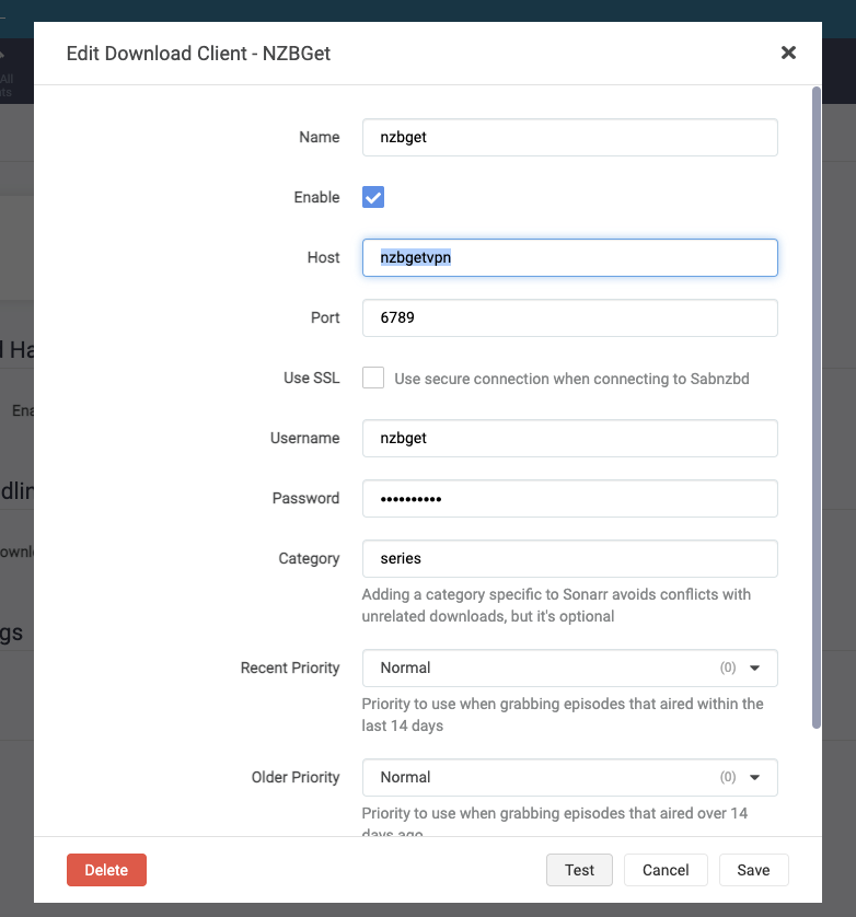

Once all relivant containers are changed to this network they can communicate with each other using the name of the container rather than an ip address.
So in sonarr, radarr etc. Goto download clients and change the host to the name of the nzbget conatainer. (mine is called nzbgetvpn)
You still need the port no as before
1048442040_Screenshot2021-04-17at07_30_55.thumb.png.0600ee1e7489bf10280330f24ee689e2.png
Now click test and it will come back all good :)
