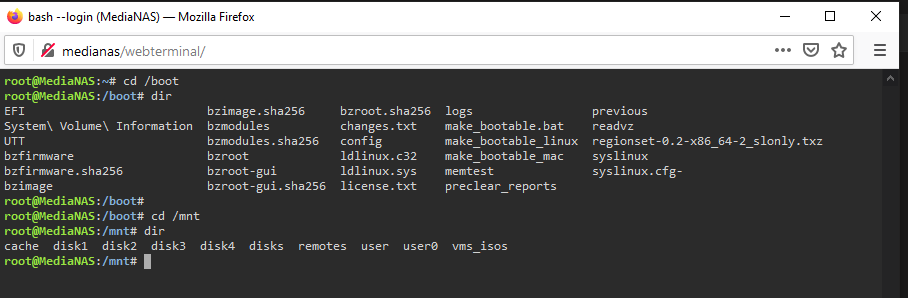

The unRAID USB flash drive is mounted at /boot
If /mnt is empty you probably do not have the proper host/container path mapping setup in the Cloud Commander docker container.   Docker and unRAID file system are separate and you need the proper mappings between the two.
The disks in the array are at /mnt/diskX
The user shares are at /mnt/user/[share name]
NEVER copy files between /mnt/user and /mnt/diskX as you could lose data.
Unassigned devices (such as external USB disks ) are at /mnt/disks and /mnt/remotes for remote-mounted disks
Here's a view of /boot and /mnt from the Terminal command line:

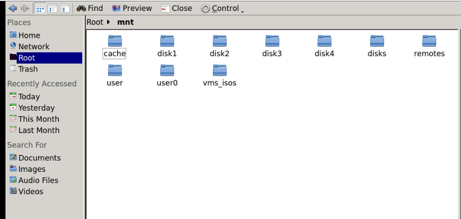

Here is a view of /mnt from Dolphin (I use this file manager docker container rather than Cloud Commander):
This view is only possible because I have the host path /mnt mapped to the container path /mnt

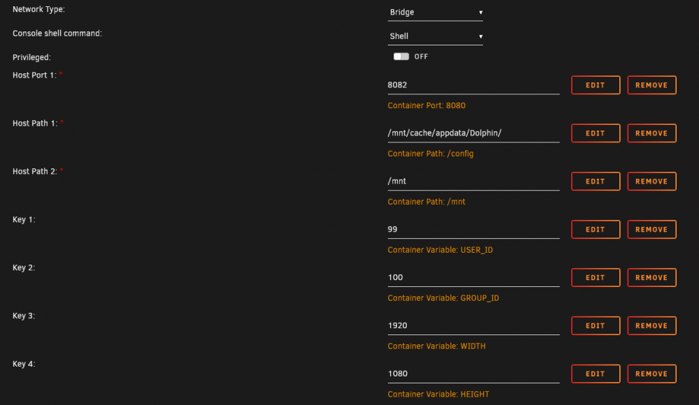

Thank you for help. Dolphin its not install fine, probably I have wrong Host path 1, I see that you have /config but its not ok. I try another few path, from internet also is not working. Have this error:
root@localhost:# /usr/local/emhttp/plugins/dynamix.docker.manager/scripts/docker run -d --name='Dolphin' --net='bridge' -e TZ="America/Los_Angeles" -e HOST_OS="Unraid" -e 'USER_ID'='99' -e 'GROUP_ID'='100' -e 'WIDTH'='1280' -e 'HEIGHT'='720' -p '/mnt/cache/appdata/:8080/tcp' -v '/mnt':'/mnt':'rw' -v '/mnt/user/appdata/Dolphin':'/config':'rw' 'aptalca/docker-dolphin'
docker: Invalid hostPort: /mnt/cache/appdata/.
See 'docker run --help'.

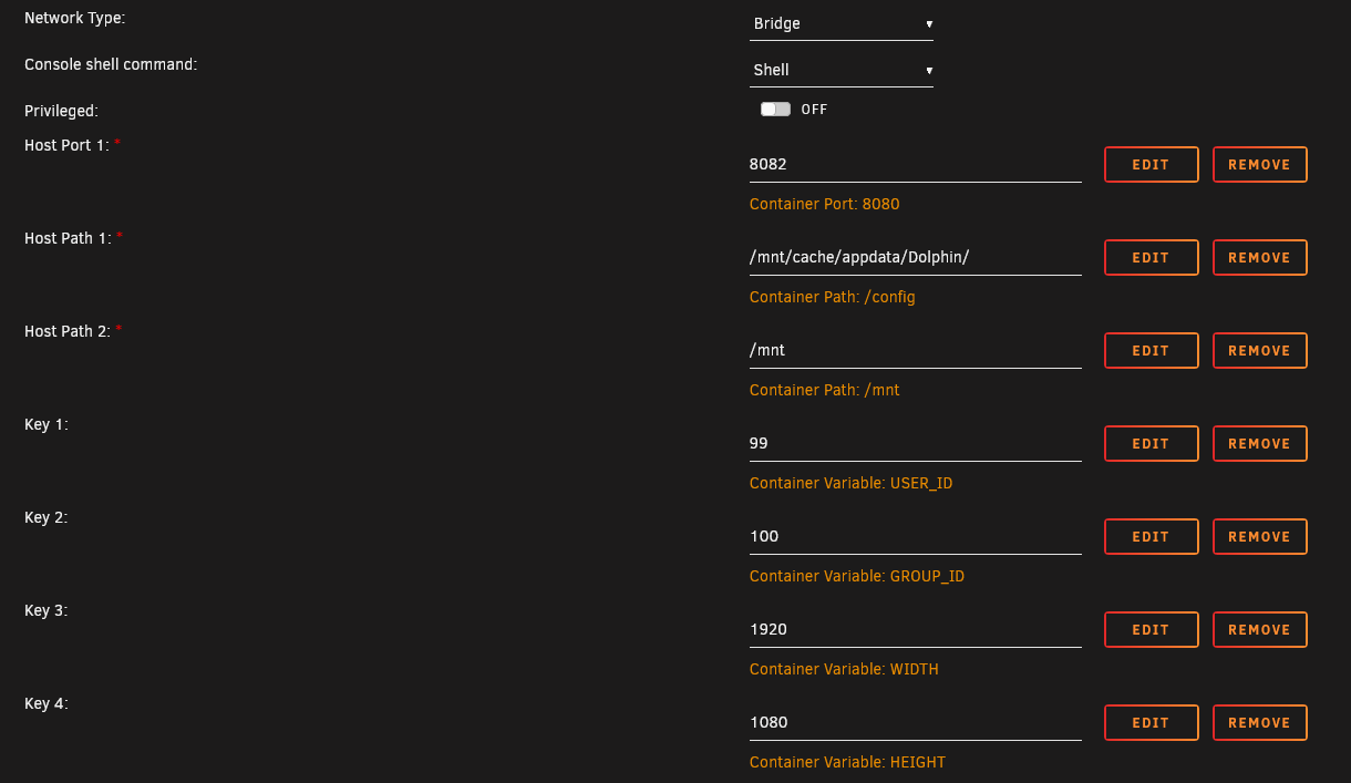

I think you are a bit confused about how to setup Docker containers.  You should read the Docker FAQ to get a batter idea how Docker containers in general work.
Here is my Dolphin setup (I have port 8082 on the host mapped to port 8080 since 8080 is in use by another docker):
