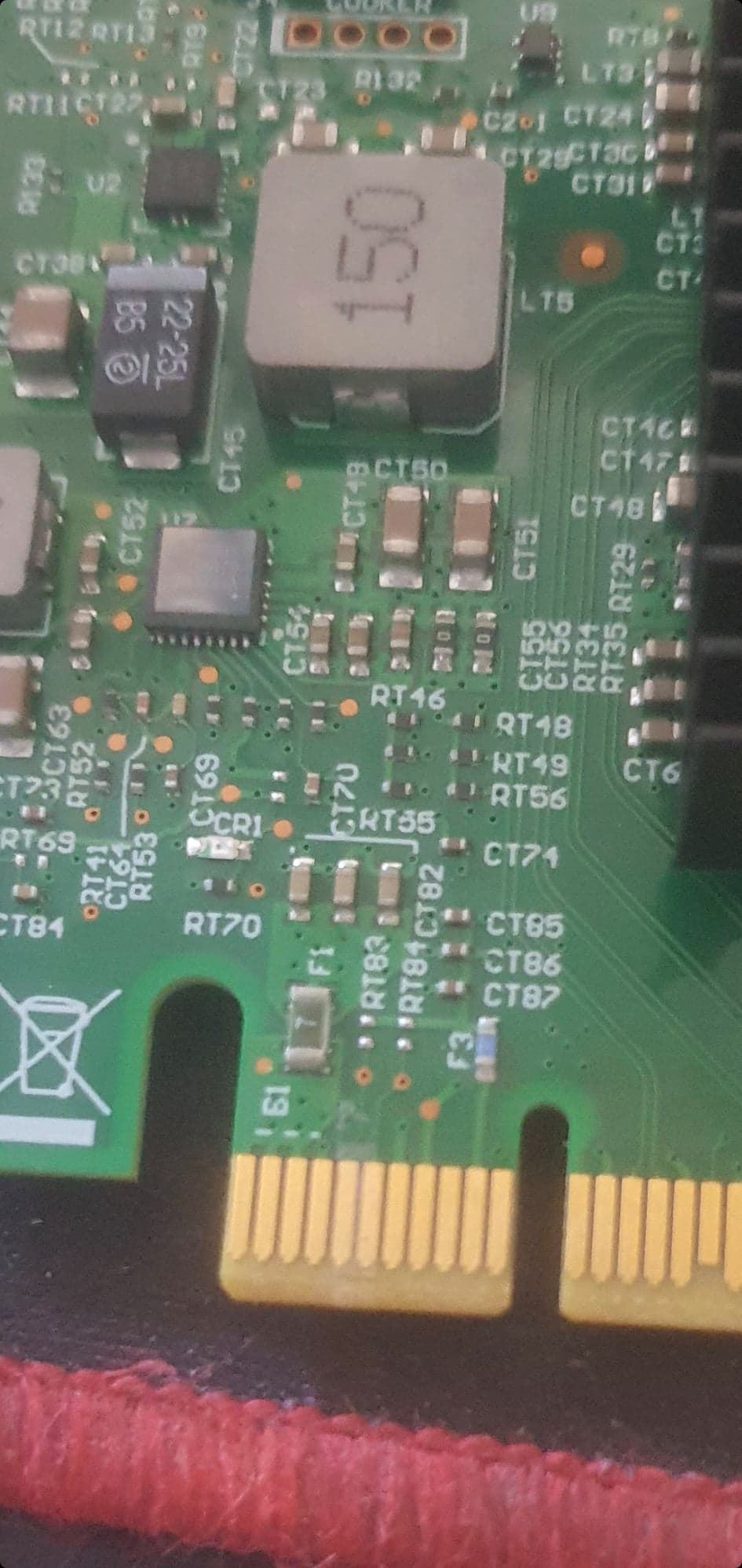

April 18, 20215 yr 1 hour ago, Dark_Surger said: Put it in and computer skips bios 1 hour ago, Dark_Surger said: Tried multiple PCI-E slots. If no post on mobo BIOS, then you should try tape ( mask ) two PCIe connect pin tick.
April 18, 20215 yr Author Hi, I can do this, but what part exactly? Will post pic. Can you circle the pins to cover please.
April 18, 20215 yr 5 minutes ago, Dark_Surger said: did i get the wrong pins? It is correct, pls recheck the tape status. If didn't work, I think no way you can fix, wait other person advice. If you have another PC, pls plug in HBA there to check does this HBA work first. Edited April 18, 20215 yr by Vr2Io
