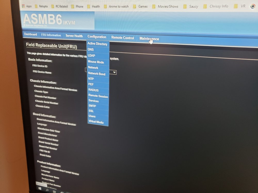

So my Nas that was running Unraid suddenly has been reinfected with asmb6 ikvm..... anyone have a suggestion?
because of this i cannot even get to the bios. It's like an infection.... Did it like undo the IT mode?
My ISP reset my modem last night now this... does anyone know if i need to flash it?
ASUS Motherboard Z9PR-D12 Socket 2011 w/ 2 x Xeon E5-2630 v2 CPU /1U heatsink  20tb HDD 500GB SSD 25 GB flash lol
I am so lost.
Thank anyone who can give any advice!!
The mobo has 3 ethernet ports. I shut down the ASMB6 through the maintenance and then unplugged the network cable that controls this gui. But from what I read it is either saved in the motherboard or it is attached to something on the motherboard? I cant find a little control unit like they showed.
