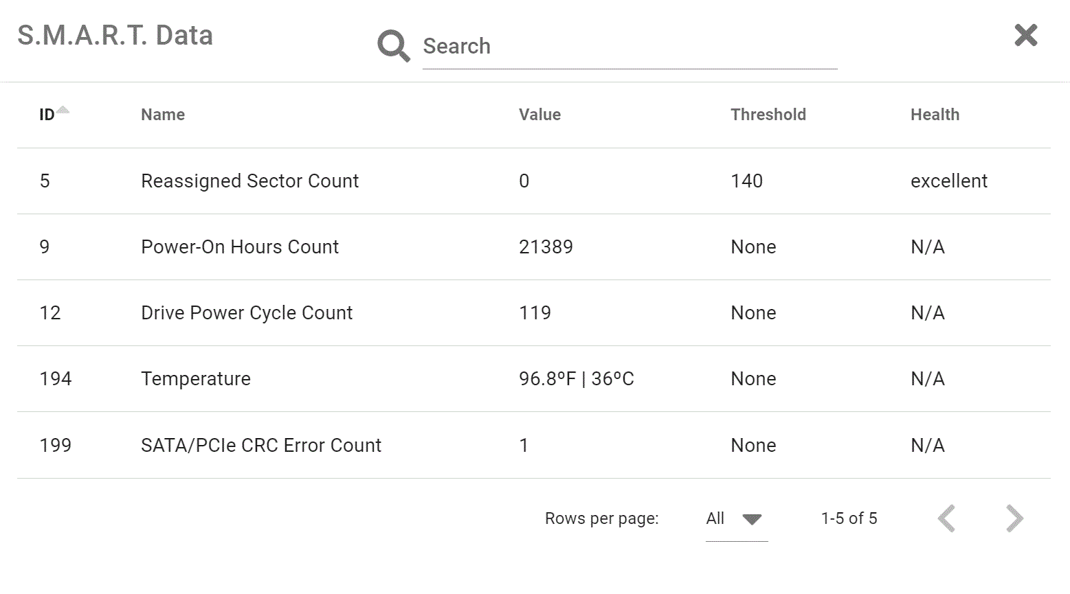

I couldn't get smart data when it was is in unraid, maybe because it was disabled.  After I put it in my windows box and deleted the volume, I was able to give it a drive letter and see it in the disk utility. At that point I could get smart data but it just said there were no errors after running an extended test for almost a full day.  Do you think its OK after doing a successful full overwrite, to put it back in the array and just monitor it for errors again?
The erase failed, I guess I'll toss the drive, after sledge hammering it.  Here is all the tool gave me for smart data.
