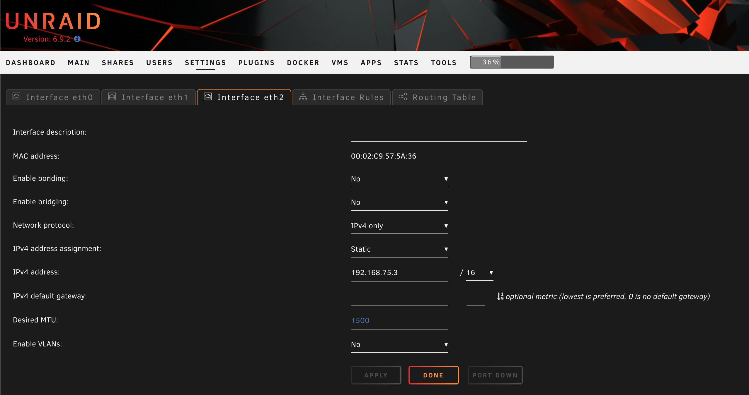

eth2 has an IP of 192.168.75.3 and a netmask of 255.255.0.0. That means it participates on the 192.168.x.x network and thus conflicts with eth0 on 192.168.0.x
You should change the netmask for eth2 to 255.255.255.0

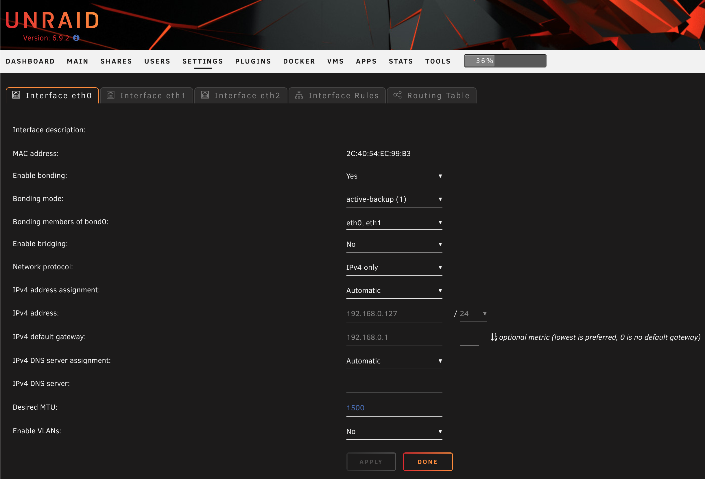

I don't seem to have the option to change the network mask.  Is it somewhere else?
Oh the webgui displays it in CIDR format... on eth2, change /16 to /24.
I would also check the rest of the devices on that network and make sure they use 255.255.255.0 (or CIDR /24) too
That did it.  Thanks!  BTW, what is the /16 and /24 representing?  I was always confused by that.
