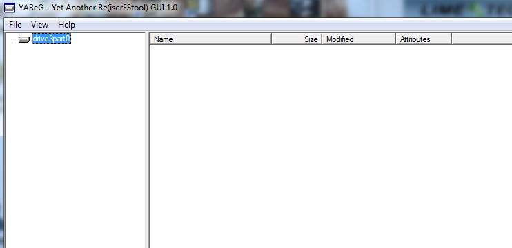

I did NOT label which drive is which so I removed what I THINK is the parity drive.
Anyway to tell?
I put it in my drive dock in Windows and opened it in the ReiserFS browser...t he YAReG thing and it shows nothing on the drive at all just says
drive3part0
Does that mean its the parity drive?
Screenshot attached
Likely, although I'll defer to someone more expert on this!
I should think the most foolproof way to check is to fire up the array and look in the listing - the failed drive should be clearly indicated.  I understand why you wouldn't want to take the unnecessary risk in doing this though...
