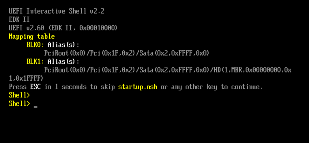

The VM appears to setup find but no luck, I boot into the UEFI Interactive Shell (rookie move I guess)
I would really appreciate it if someone could point me in the right direction please.
Can you type exit and then find a boot option it likes?

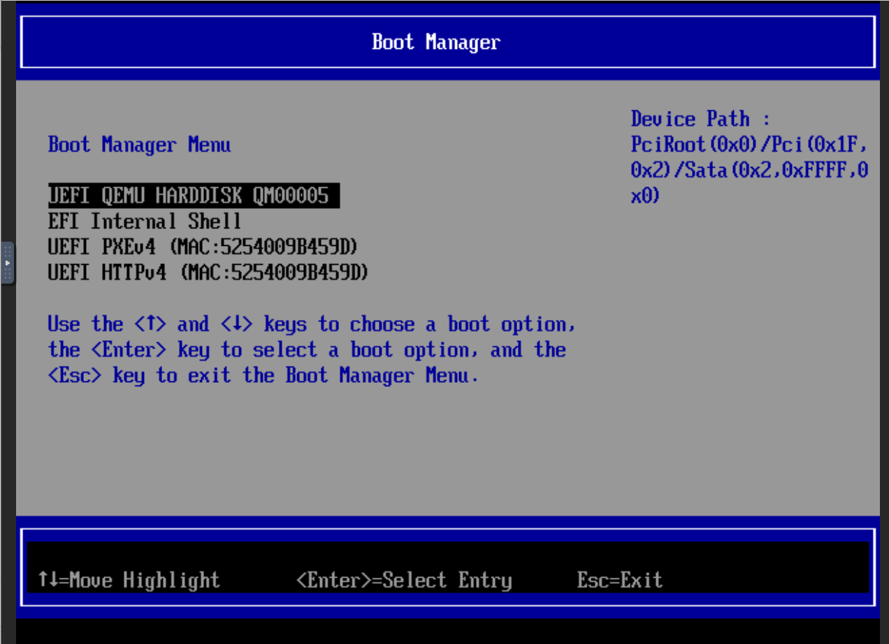

Thanks for the response @joecool169.  Here are the boot options I have, none of which that work.
