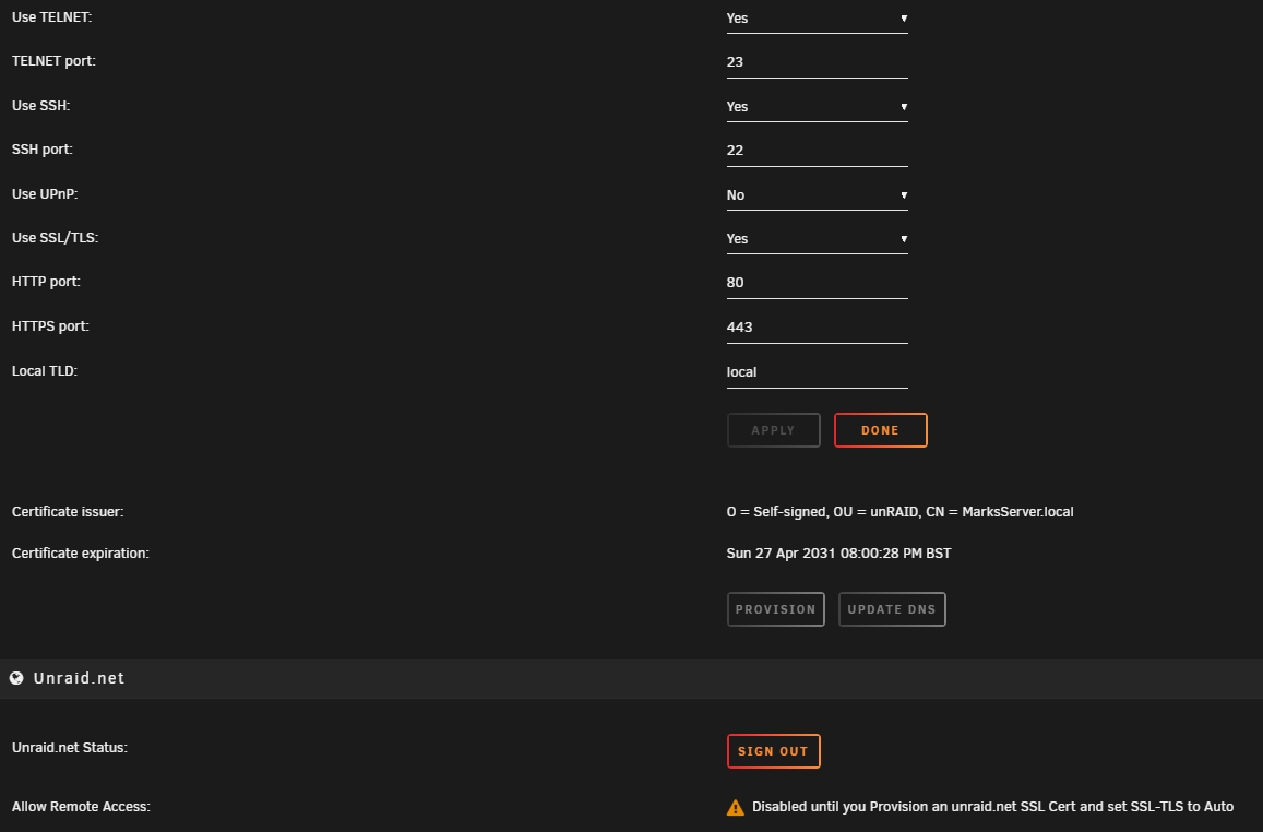

So I loaded on the unraid gui to and turned off SSL/TLS to regain access. But the renew button was greyed out. (I updated the DNS), I needed to renew the SSL as I had a new router.
I've deleted the SSL configs on the flash drive to see if I could provision, but now it's greyed out with a date in the future :(
Can anyone help with reprovisioning? I'm using an Asus RT-AX88u and have set my DNS to google.

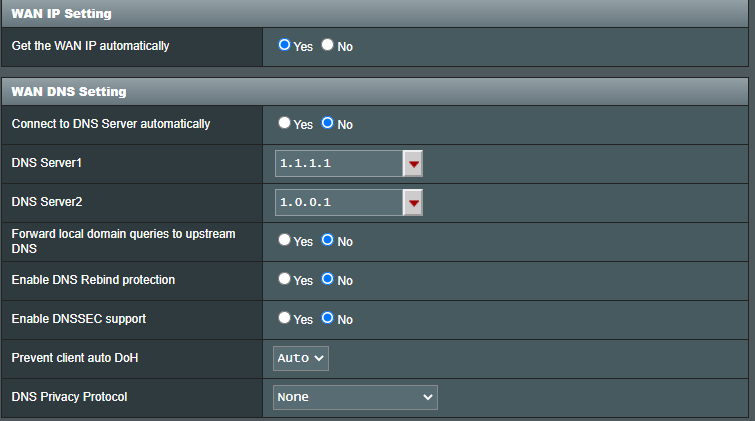

Now I'm banging my head with this, Put Merlin firmware on the Asus router to see the extra options.
DNS rebinding protection turned off

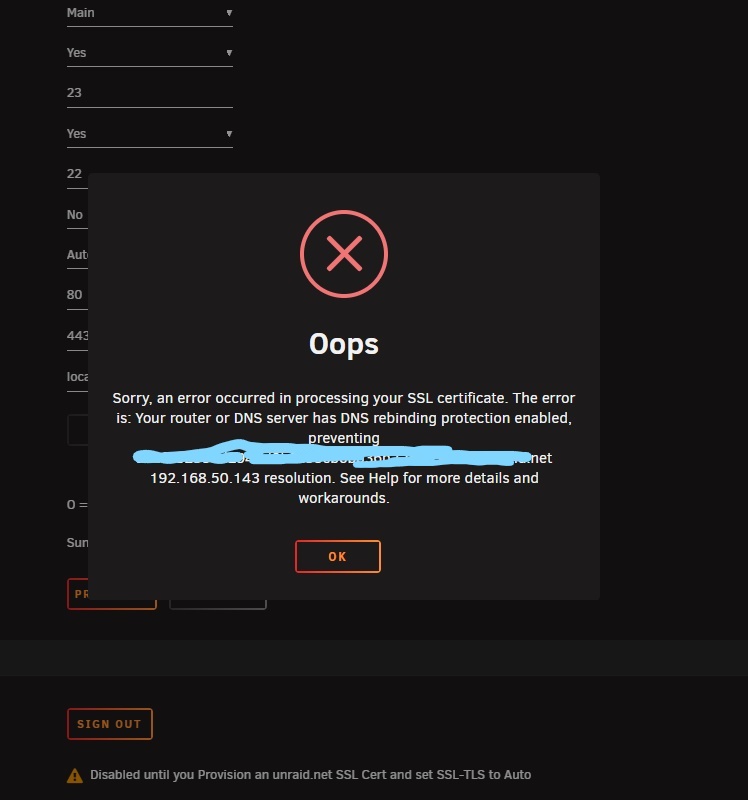

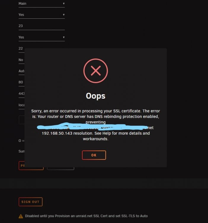

DNS Servers changed to google/OpenDNS and then Cloudflare. Getting these errors still.
Restarted unraid.net API

On your client computer (not Unraid) open a command prompt and type:
   ping yourpersonalhash.unraid.net
(the easiest way to get yourpersonalhash is to copy/paste it out of the error message that you took a screenshot of)
What is the result?

The IP address is wrong as I've changed routers and update DNS is greyed out :( So the Hash is pinging my old local IP address.
OK DNS is resolving so DNS Rebinding is not the problem.
This is a actually a bug... if the local IP changes AND the SSL cert gets deleted then DDNS does not update properly. It works fine if only one of those changes, but not both.
