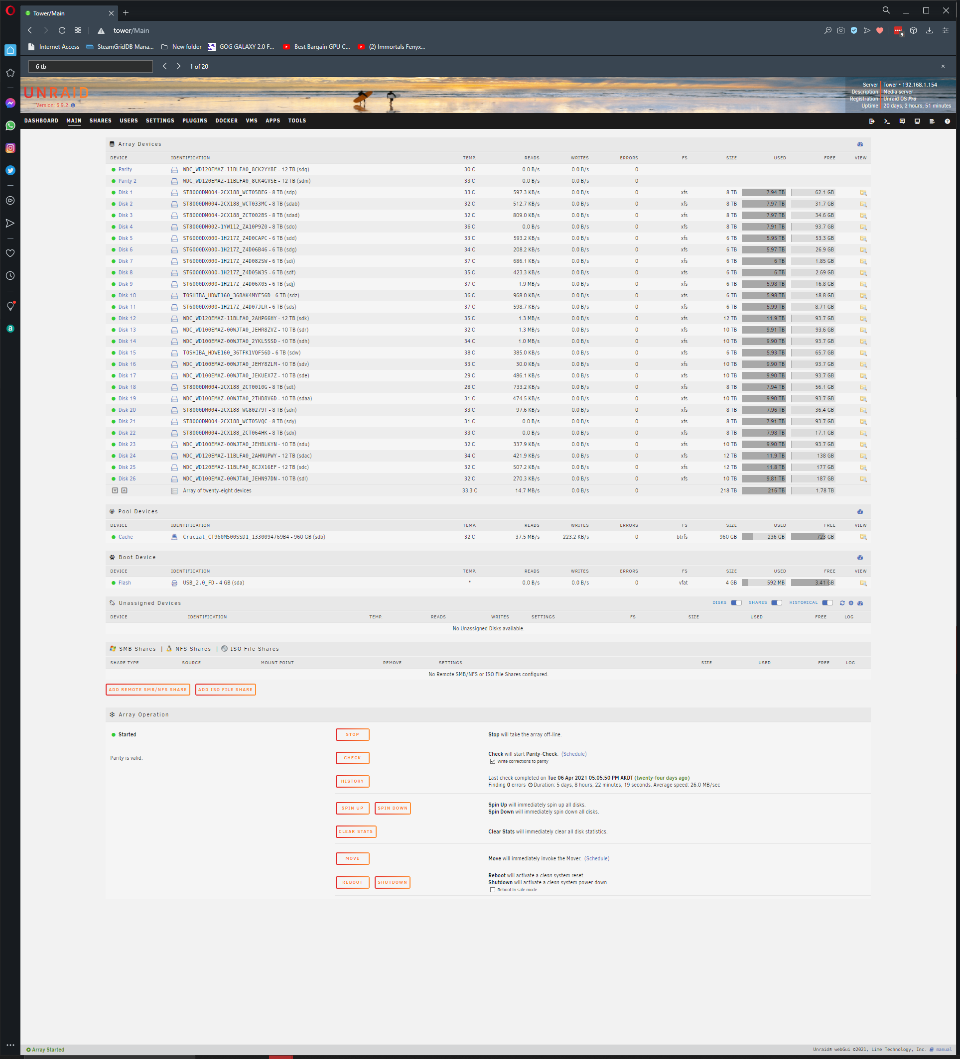

Here is my array (attached screenshot) - very large and kind of slow on parity checks etc. -

thanks codefaux.  a parity check takes a hell of a long time right now 3 to 5 days.
Does not seem right, unless you are making very high I/O on the Array during parity check.
It should be roughly depending of Parity drive size and it only takes me 1 day, 13 hours, 32 minutes for a 18TB.
If you are running parity now, your diagnostics could give more explanation why it is so long.
ChatNoir, I shut down all the dockers and restarted them and it went back up in speed.  However i did do a diagnostics before i did that.  Where would i look?
@FrozenGamer, as you want, maybe a docker was accessing tons of stuff it was thinking was new, a backup was running or something and you are good now. Maybe there was something else and it might come back later.
What's your usual Parity check duration ?
