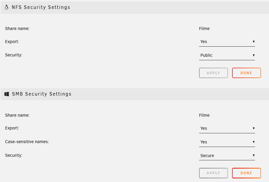

And I created a few shares with SMB and NFS support:
This should make the share visible to all system around. There should be no firewalls around, as I have not setup anything for unRaid nor the Ubuntu VM.
I seem to not get the share mount though.

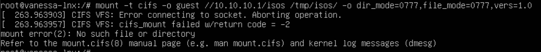

When testing I get:

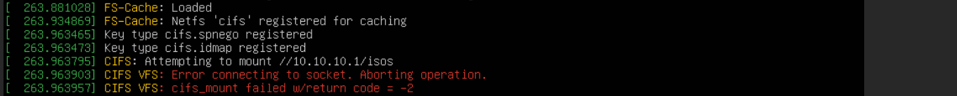

When mounting I get:
it does not matter if I take a known user or not, same results. Irrelevat of the SMB version: 1.0, 1.2, 3.0

It seem though like the VM does not reach the Share allthough on the same host system.
Someone, any ideas ...

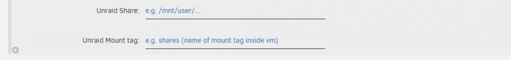

With linux vms you can have a share as a mount point.
Yes, but unless things have changed, performance was abysmal using that method.
I'd love to see some updated benchmarks though.

@SimonF: I will gain have a look into this option, allthough I wanted the CIFS share for this design.
