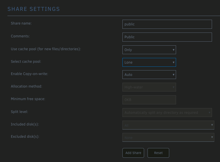

I'm using unRAID 6.9.
I have 2 pools: cache, and lone, each one with only 1 disk.
I tried for the first time to create a share (see screenshot) using the cache pool lone, but I have been unable to.
This is the error I see in the syslog:
May 15 14:16:11 Tower emhttpd: shcmd (1409): mkdir '/mnt/user/public'
May 15 14:16:11 Tower root: mkdir: cannot create directory '/mnt/user/public': No medium found
May 15 14:16:11 Tower emhttpd: shcmd (1409): exit status: 1
May 15 14:16:11 Tower emhttpd: shcmd (1410): rm '/boot/config/shares/public.cfg'
If I create a share using the array disks it just works.
I already tried several things, stopping-starting the array, restarting the server, creating the share using the other pool named cache, but nothing. I also search the forum for solutions, found similar threads, but all of them without a useful answer.
Why can't I create a pool-only share?

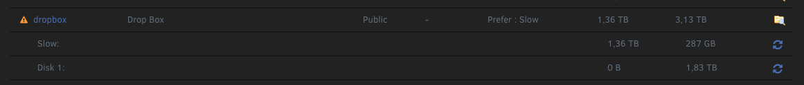

I tried to change from cache only to cache prefer and I was finally able to create the shares. Only... it's now writing exclusively to disk1 of the array and never to the pool. Moreover I have data in the pool disk that should fall under the user share and it doesn't show anything!! What's going on???

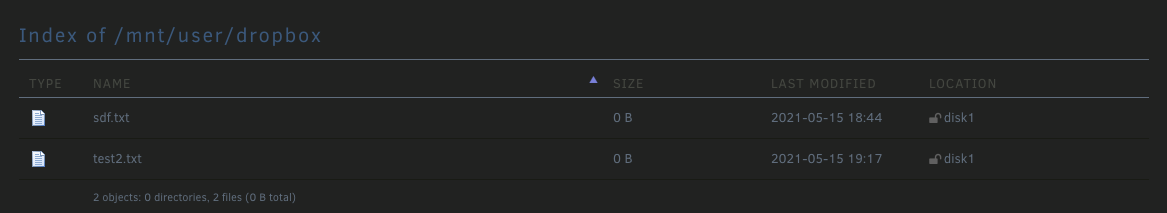

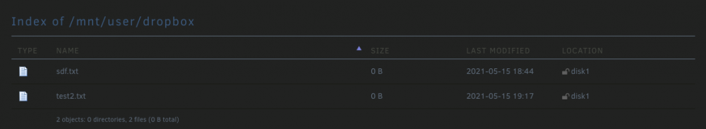

OK, I believe it's the same problem. It's writing on disk1 because it can't do it in any of the pools.
That's why the only-cache type of share can't be created whereas the prefer does; it's able to create it on disk1 of the array while failing to do it on the pool disk but at least it can "deal with that".
At the same time shfs - is this the process that shows all the disk folders as one under /mnt/user, right? - isn't able to read data from any of the pool disk directories. And yet the webGUI is able to show it (see attached screenshots).
