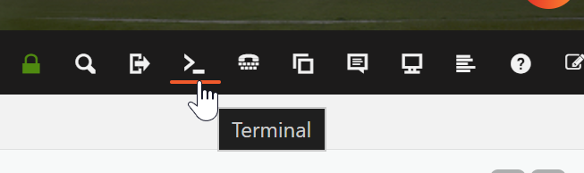

open the Unraid terminal
Could you elaberate where to download unraid, when I went to the unraid site and downloaded the creator it then said it will erase my hard drive. Possibly im not in the right area. could you tell me the site where to get unraid terminal
