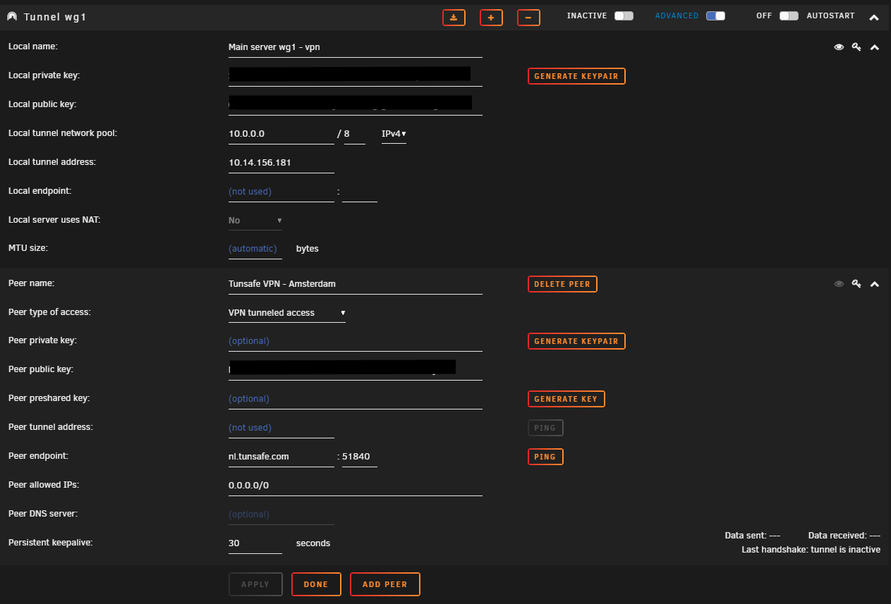

So, here is a TunSafe config:
[Interface]
PrivateKey = ************************************
Address = 10.34.234.162/8
DNS = 1.1.1.1
[Peer]
PublicKey = ******************************************
Endpoint = 190.2.141.162:51840
AllowedIPs = 0.0.0.0/0
And here is the TorGuard config:

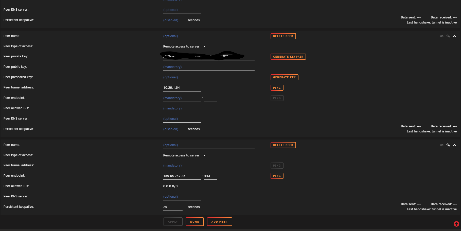

UPNP is off. I updated the plugin. I imported the TorGuard conf. It still doesn't work, though the active switch no longer flashes. It switches to Active, but once you reload the  page or navigate away and then go back to vpn settings, it is off. Are there log files I can send you? Here is a screenshot of what the imported tunnel looks like.

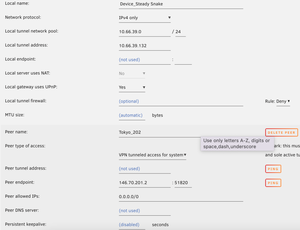

I miss a couple of mandatory fields. These should be present in the config file generated by TorGuard
  1. Local private key - generated by TorGuard
  2. Peer public key - generated by TorGuard
  3. Peer endpoint - this is the URL of the TorGuard VPN access
  4. Peer allowed IPs - this should be 0.0.0.0/0
Here is a screenshot of my VPN connection
Edited by bonienl

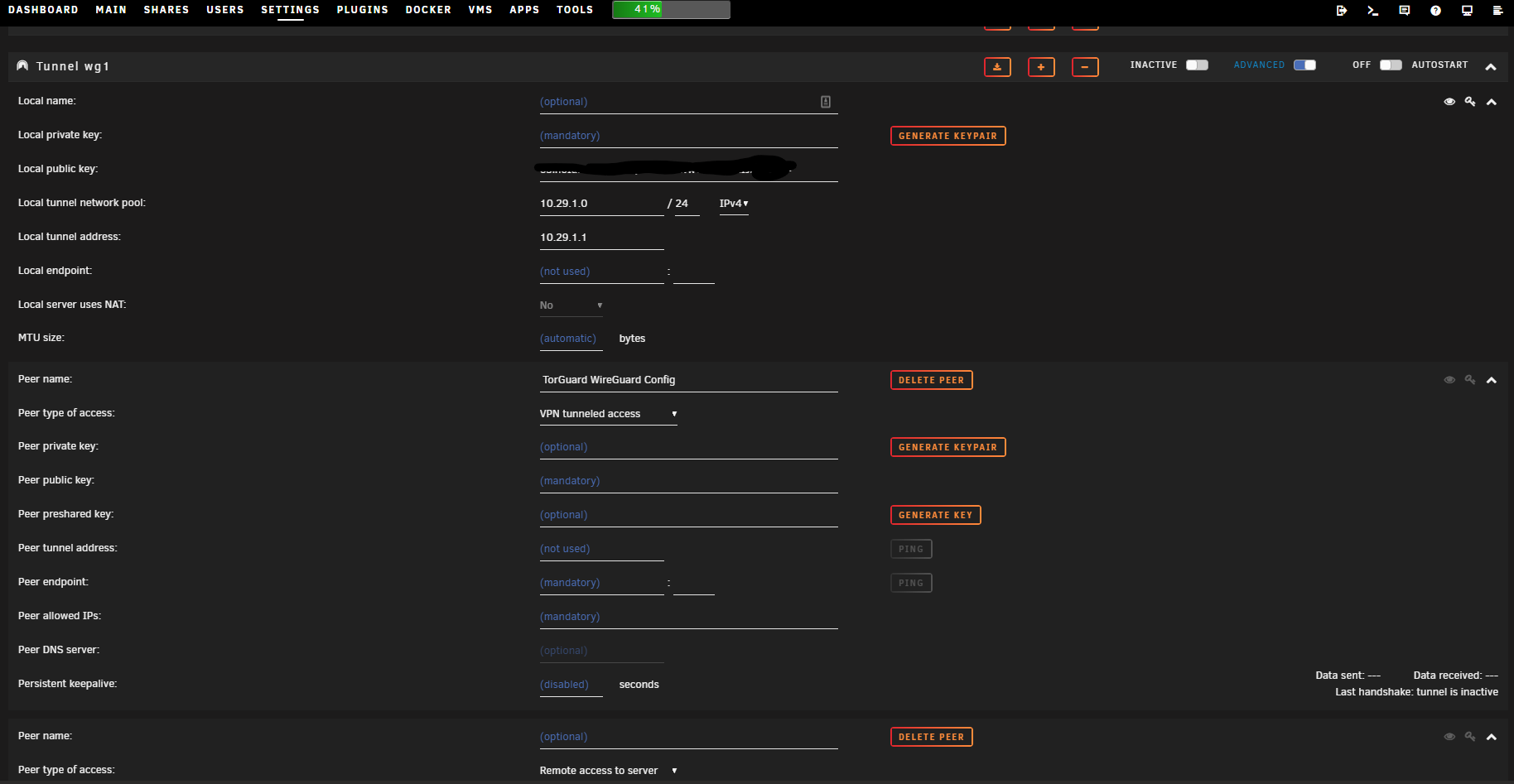

The config files look alright, but in your screenshots there are missing mandatory fields.
Did you remove those fields or they are not populated after importing the config file?
What happens when all fields are filled in (see also my screenshot)?
To answer your question, no, those fields are not populated during the config file import.

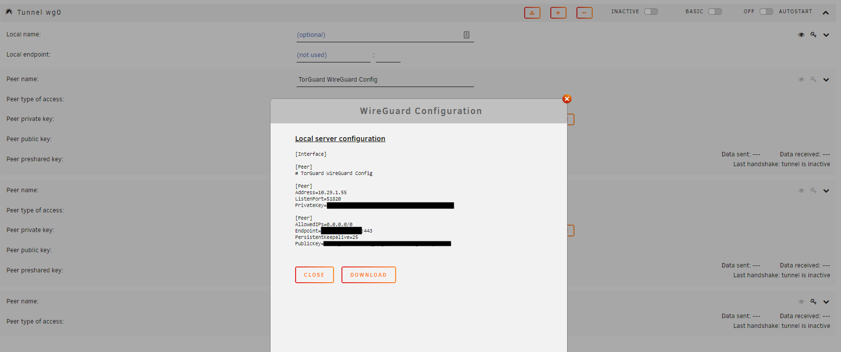

Following Mantene's suggestion, I also got it to work tonight by removing the comment at the top and removing any empty lines between the [Interface] and [Peer] entries.
Importing the original config untouched
# TorGuard WireGuard Config
[Interface]
PrivateKey = yyyyyyyyyyyyyyyyyyyyyy
ListenPort = 51820
DNS = 1.1.1.1
Address = 10.29.1.55/24
[Peer]
PublicKey = xxxxxxxxxxxxxxxxxxxxx
Endpoint = 111.111.111.111:443
PersistentKeepalive = 25
would give me 4 sections total:

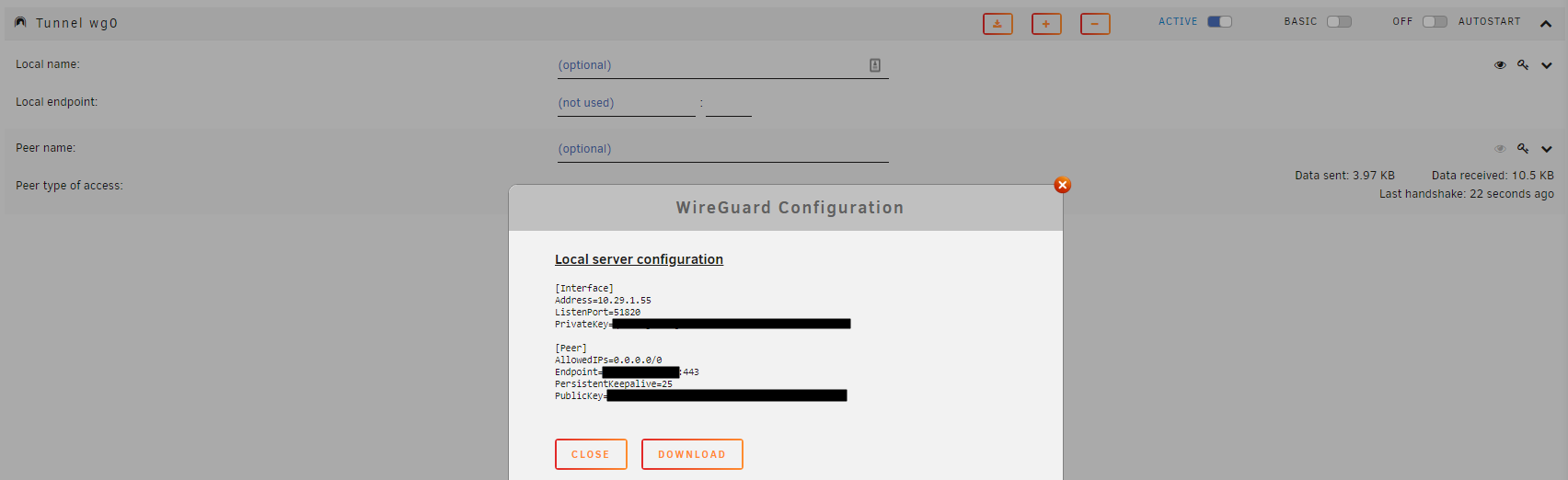

whereas the more compact version
[Interface]
ListenPort = 51820
DNS = 1.1.1.1
[Peer]
would give me 2 sections:
The 2nd version was connecting fine, so I think it's just the import config parser that's messing up the setup.
