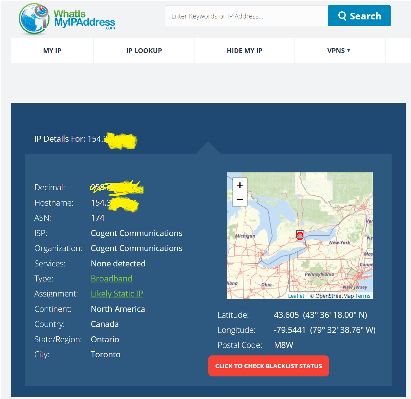

Hi All, (@ljm42)
Just confirming that PIA will work with unRAID.
I have had it up and running for over a week now; not one issue.
As directed, I have been verifying via the jlesage/Firefox Docker.
While not for the faint of heart (nor as easy as Jorgen, ICDeadPpl, and ljm42 have made it by simply installing a provider config) this link to a PIA support page will get you set up. Follow the instructions though!!! Actually read the readme.md file as there's important info in there. Lastly, make sure you are using the "manual-connections-2.0.0" setup zip/tar.
As always, thanks to the GREAT community here for making all of this possible!
