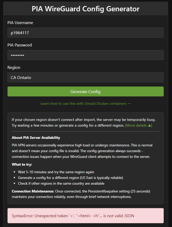

  2. Thanks for the post. I just noticed this but I don't see a docker data directory for PIA-WG-Config-Generator in my appdata folder. I also don't see a container variable specifying the datadir so where exactly would I replace the piawg.py file?

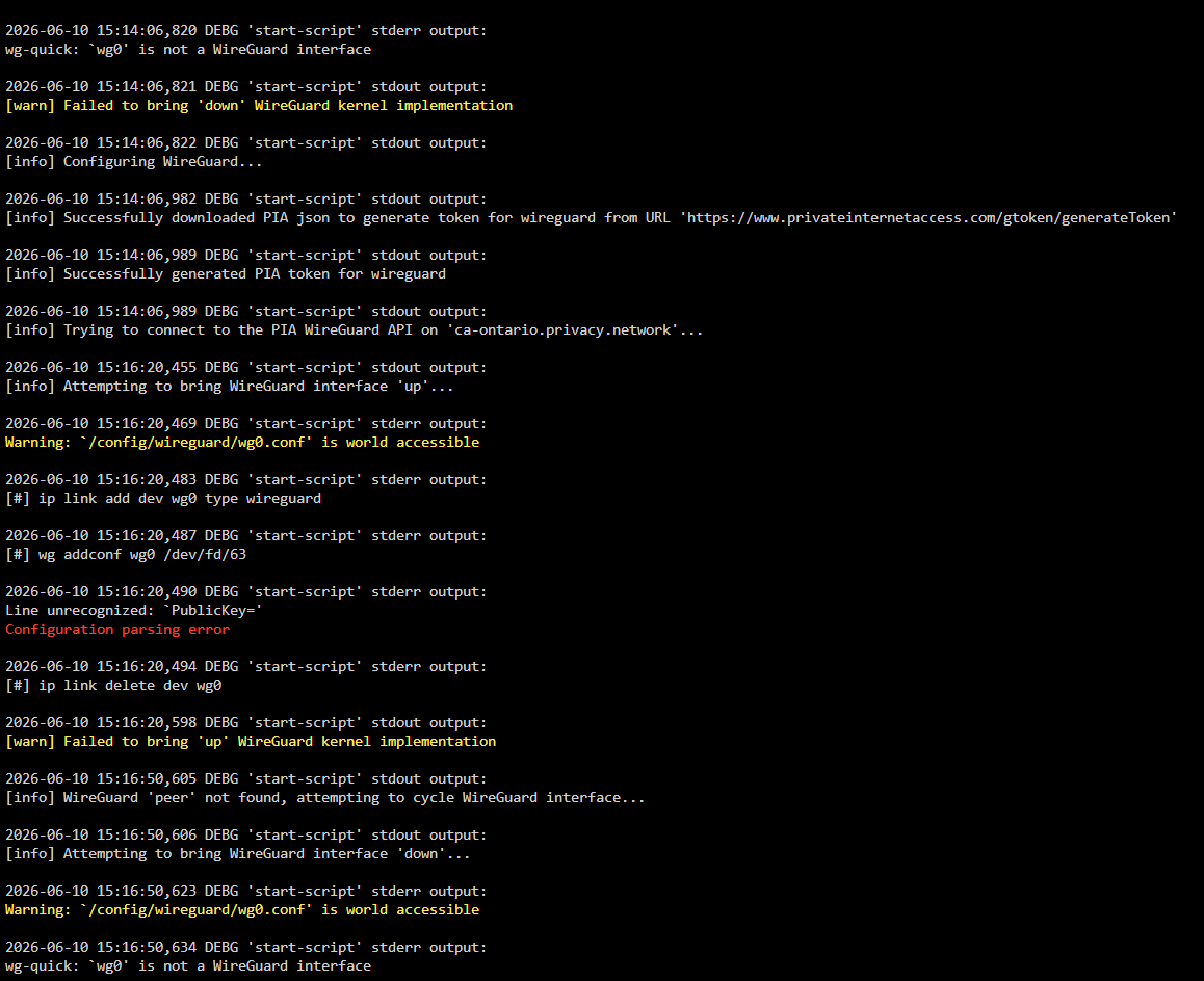

  3. I know this is a custom docker from SpaceInvader but I couldn't find a support page in the forum. Sorry if I missed it and this is the wrong section to post. Anyway, since PIA recently changed some of their endpoints, the configurator doesn't seem to work. I'm not sure if these two are related or not but ever since the change, I'm having issues getting a proper config file from a server that supports port forwarding. Does anyone know how I can fix this? The wg0.conf file in my /cache/appdata/wireguard-easy/ directory has file permissions that won't allow me to view it. I know how to change them but thought I'd ask here first if anyone knows why SI's docker isn't working? EDIT: Ok, I was able to find a server (Netherlands) that generated a file correctly. I then had another issue to get Prowlarr and Flaresolverr talking to each other behind by custom WG PIA VPN network (had to add a Host variable of 0.0.0.0 to Flaresolvver to look at all incoming traffic) and now my indexers are working again. Prefer a physically closer server than Netherlands but for now at least I'm running again.

  11. Well, this is super easy to configure and essentially offers the same benefit as the VPN enabled dockers. I didn't change containers as mentioned, just disabled the built-in VPN and moved all my dockers over to the tunnel network. Anyone just starting out and wanting to put "all" their containers behind a VPN should use the method in the video. It's way simpler now with the advances in the OS and use of Wireguard.
  12. I ended up just configuring a Wireguard Tunnel to work with PIA per this video and just disabling VPN on my binhex VPN containers (vs installing the non-VPN versions):

  14. How's this I think I am...I was using CA Ontario. When I tried to use SpaceInvaders config app, it hangs on this server but I can generate US East no issue. EDIT: But the weird thing is my Sabnzbdvpn docker from Binhex works just fine with same config. I think I just need to setup wireguard thru PIA and route all docker containers thru it - instead of using these VPN dockers.
