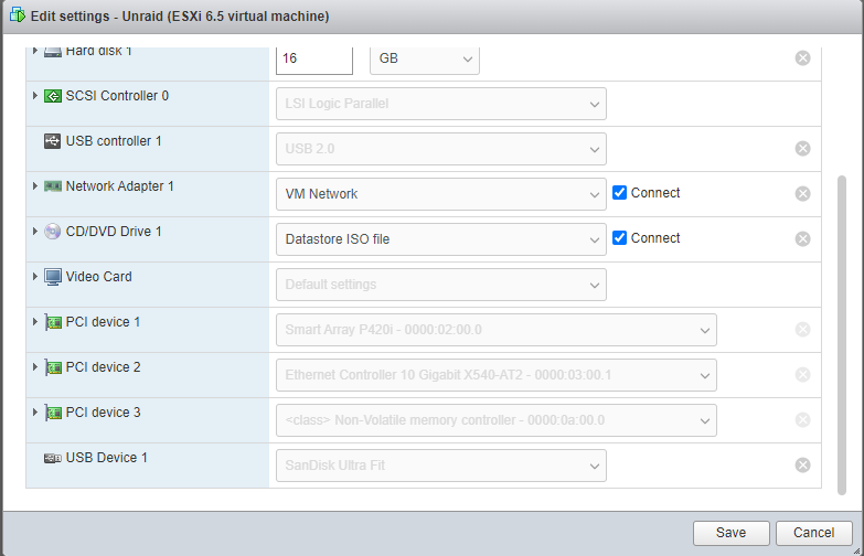

  1. I have been trying to talk to some people at the vmware community, and they are genereally of the idea that when it is passthroughed to the vm, then esxi has nothing more to do with it. And saying maybe i need some driver for linux. I found this: https://support.hpe.com/hpesc/public/swd/detail?swItemId=MTX_42b6aa58956a438aa85bd73d0f#tab3 but it asks for rpm to install, and i dont know if that is possible in unraid. am i on the right track here ?
  2. little update. i tried to add append mpt3sas.msix_disable=1 as it says in but it did not help. Also tried to update esxi to 6.7, also did not help. also i am not sure if i matters but vsphere says something about the guest os being wrong

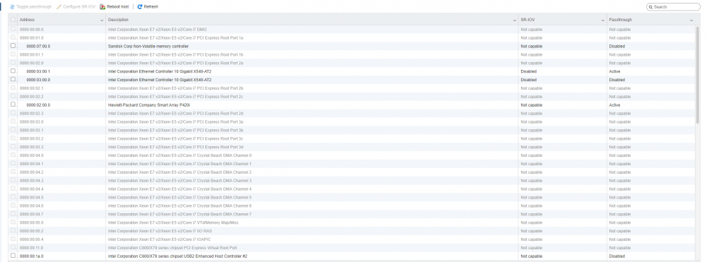

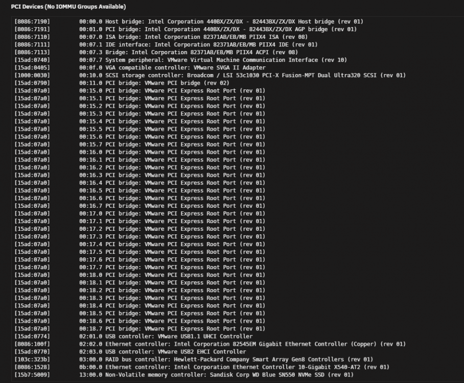

  3. I searched for p420 and nothing came up. If i try to search for "hp" then i afew things like: hpsa 0000:03:00.0: failed to enter simple mode hpsa 0000:03:00.0: Logical aborts not supported 03:00.0 is the smart array, and here is what it says about Aug 18 12:41:23 SausageMix kernel: pci 0000:03:00.0: [103c:323b] type 00 class 0x010400 Aug 18 12:41:23 SausageMix kernel: pci 0000:03:00.0: reg 0x10: [mem 0xfd300000-0xfd3fffff 64bit] Aug 18 12:41:23 SausageMix kernel: pci 0000:03:00.0: reg 0x18: [mem 0xfd4ff000-0xfd4ff3ff 64bit] Aug 18 12:41:23 SausageMix kernel: pci 0000:03:00.0: reg 0x20: [io 0x4000-0x40ff] Aug 18 12:41:23 SausageMix kernel: pci 0000:03:00.0: PME# supported from D0 D1 D3hot Aug 18 12:41:23 SausageMix kernel: pci 0000:03:00.0: disabling ASPM on pre-1.1 PCIe device. You can enable it with 'pcie_aspm=force' Aug 18 12:41:23 SausageMix kernel: hpsa 0000:03:00.0: Logical aborts not supported Aug 18 12:41:23 SausageMix kernel: hpsa 0000:03:00.0: HP SSD Smart Path aborts not supported Aug 18 12:41:23 SausageMix kernel: hpsa 0000:03:00.0: failed to enter simple mode Also here is the pastebin from the syslog: https://pastebin.com/qLb01G35 and a few more pictures from VMware and Unraid

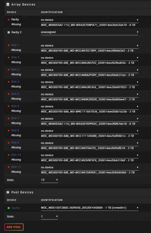

  4. Greetings everyone! So i have an HP DL380p gen 8 server, with a p420i that is configured for HBA/IT-mode. I have been running this for a while now with unraid running as bare metal, and it has been running fine. Sure it took some configuring to make it work, like changing to hba mode, installing hpsahba plugin and so to make it work. Anyways, i am pretty familiar with vmware esxi, and wanted to run it on the bare metal, as i got my hands on a nvidia grid k2 card that i have installed in the server to use with vm's that has to run on esxi 6.5. The short version is when i run unraid on esxi, add the unraid usb to the vm, and passthrough the pci devices that is needed like the p420i etc, i get the array controller show up under system devices, but no disks. When i boot straight into the same usb and run unraid bare metal, then there is no problem. Does anyone have any idea why this happens ? I have tried to boot via PLOP and that gives the same result. Update!, It turned out that i needed to update to esxi 6.7 and even after i had done that it still did not work, but it was because i had forgotten to upgrade the esxi compatibility to 6.7u2 aswell. Big thanks to @AgentXXL for staying up with me and trying to work this out! ❤️ Best regards -Apil

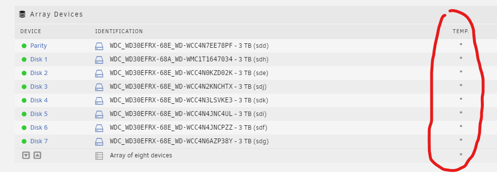

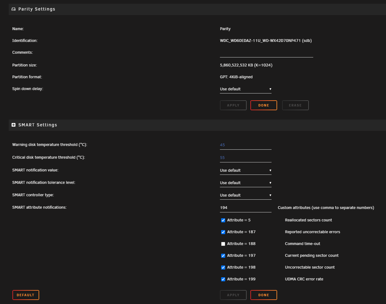

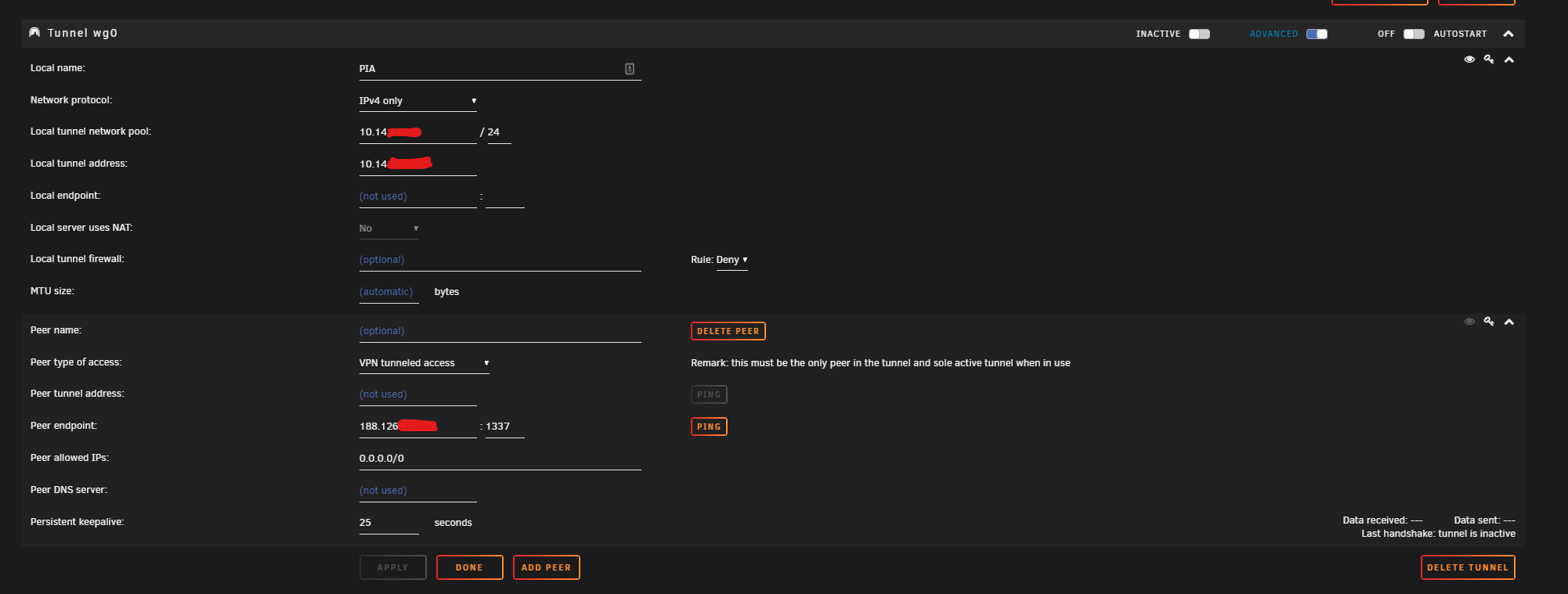

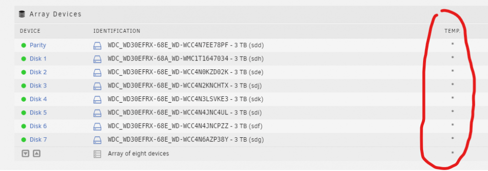

  5. Hi @Patrizzle Thanks for your reply, happy i could help you. Though getting temps by filling in 194 does not seem to fix it for me Even though i see the Attribute of Temperture celsius comes up as 194 in the list. BR Apil
  6. I am missing something, as i have tried to add the bridgenetwork to the allowed peers, but then i cant reach my dockers on those ips locally anymore. I am trying to have my dockers, or the whole unraid server route all traffic to the internet through my vpn, but still be able to access all of my unraid server and its dockers as normally via lan. Where am i going wrong ? BR Apil

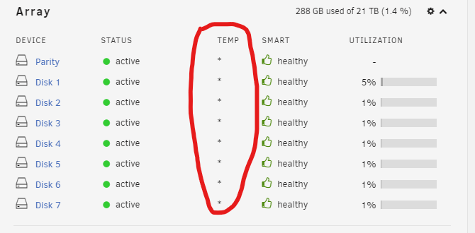

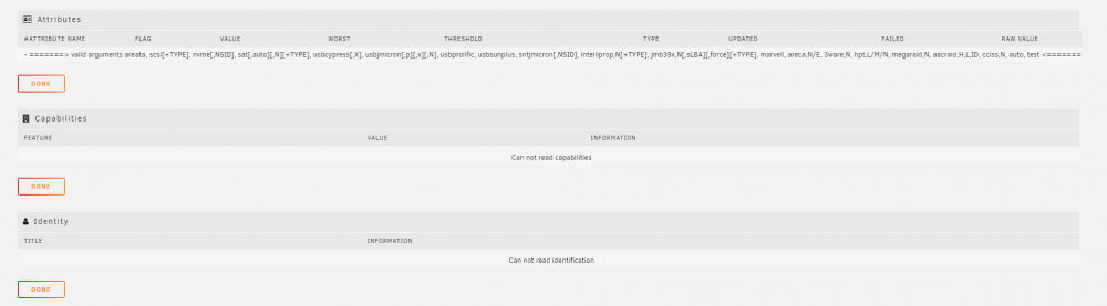

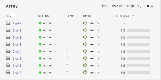

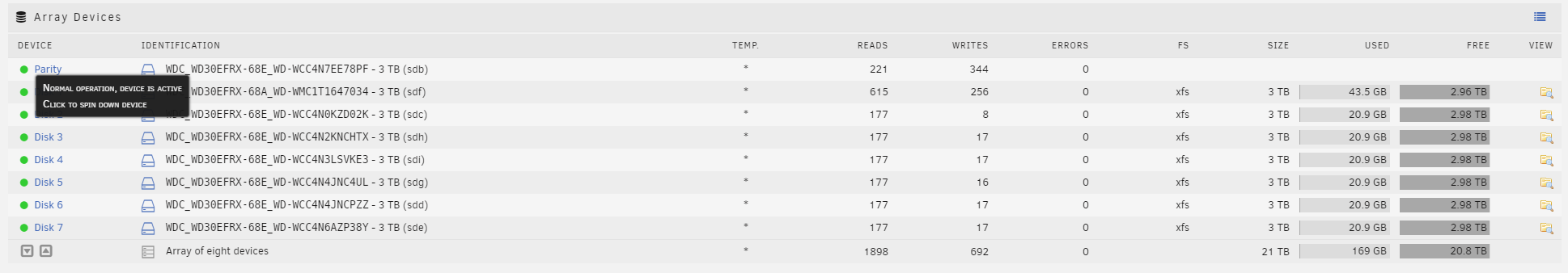

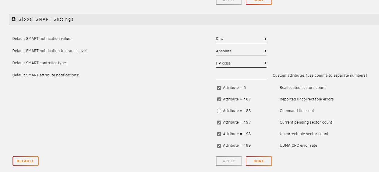

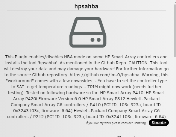

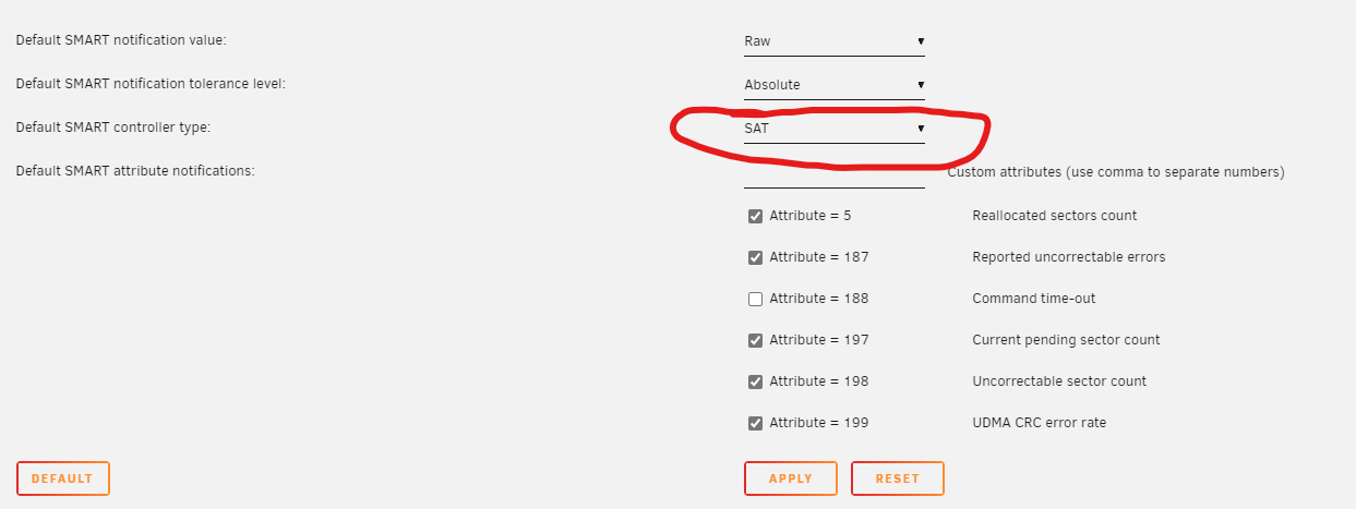

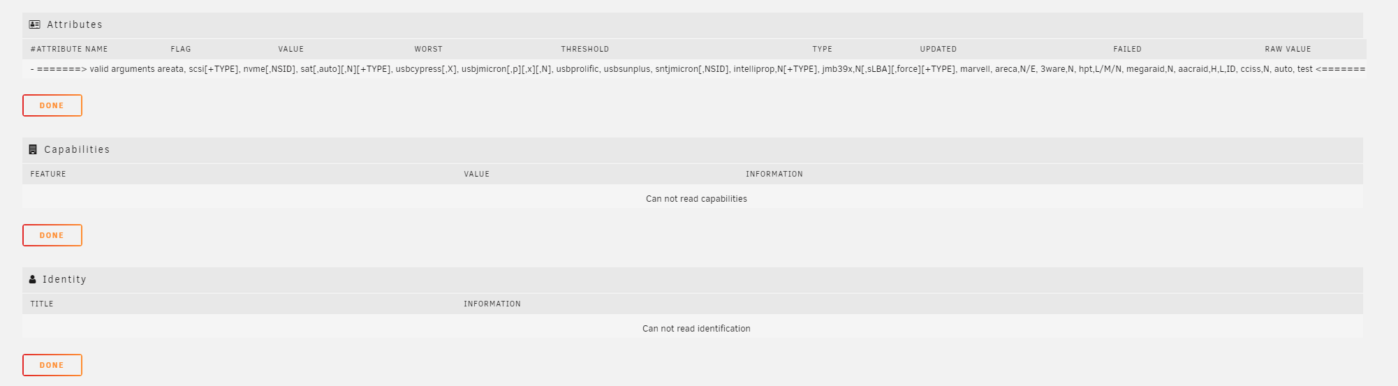

  7. Hey everyone. So i am trying to get the Dynamix Wireguard Plugin to work, to have my unraid server only communicate internet traffic through my vpn. I got everything work with importing the config, and connection is being created., but maybe a little too well. Because when it is up and connected, then i cannot reach the unraid server anymore via LAN, but ALL traffics seems to go through the VPN. I am looking for an option to ignore my lan and input a lan subnet somewhere, but cant figure it out. Anyone able to help ?
