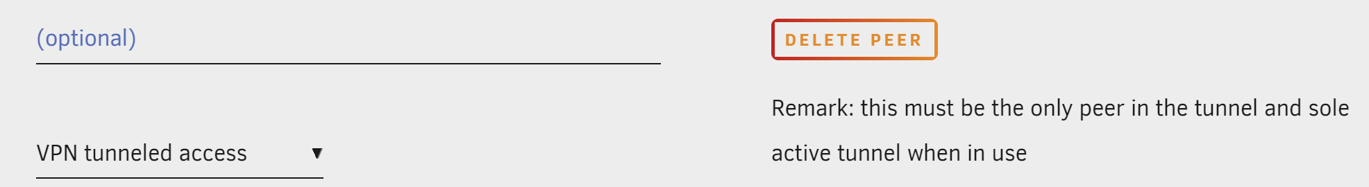

I also had a question, is it possible to have "Remote tunneled access" and "VPN tunneled access" at the same time? i always want my unraid box to connect to the internet via my VPN but i also wanna be able to connect to my LAN remotely, and also take advantage of the VPN.
Is this possible?
the "Remark: this must be the only peer in the tunnel and sole active tunnel when in use" on VPN tunneled access seem to indicate this is currently not possible, but would it be feasible to implement?

Hopefully folks are able to see this message in the webgui when setting up VPN tunneled access?
Things won't work right if you start a second tunnel while "VPN tunneled access" is active.
Thanks for the response ljm42!
I actually figured out the issue, which of course was a simple user-error on my part. I was trying to forward ports from my router, when I should have opened a port with my VPN who provides a random number that I entered into the "Local endpoint:" field as  "hostname.dynamicdns.org:55555" with 55555 as an example of the provided port. I then removed and updated the tunnel on my mobile device client and voila, handshake successful and active, even when the server is already tunneled to my VPN.

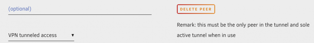

This may answer my second question. I am fine with all my traffic from this particular Unraid server (server01) going through PIA VPN. I would like to be able to remote IN to my LAN though. Do I just install WireGuard on another server (server02) for that Peer Connection? As always, all feedback/directions are greatly appreciated!
