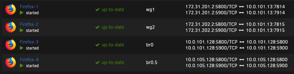

You can assign a docker container to a WireGuard tunnel just like another interface.
In the example below I have 4 browser containers, each connected to a different network, two of them use a VPN tunnel (wg1 and wg2) and hide my IP address
