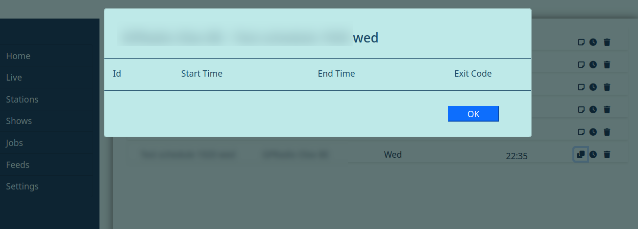

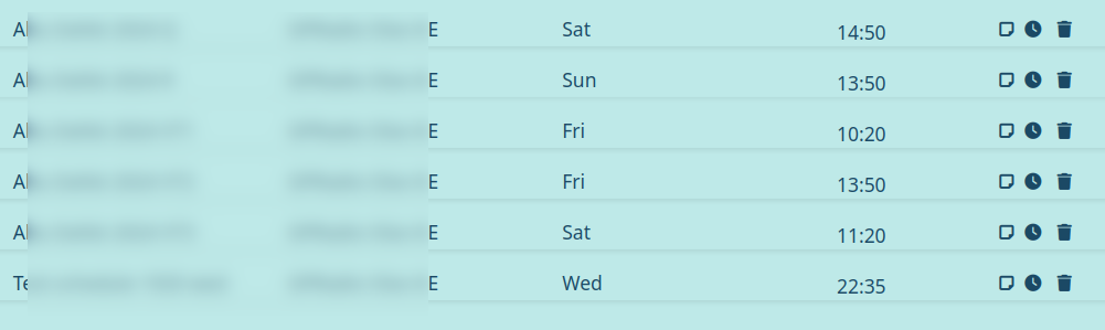

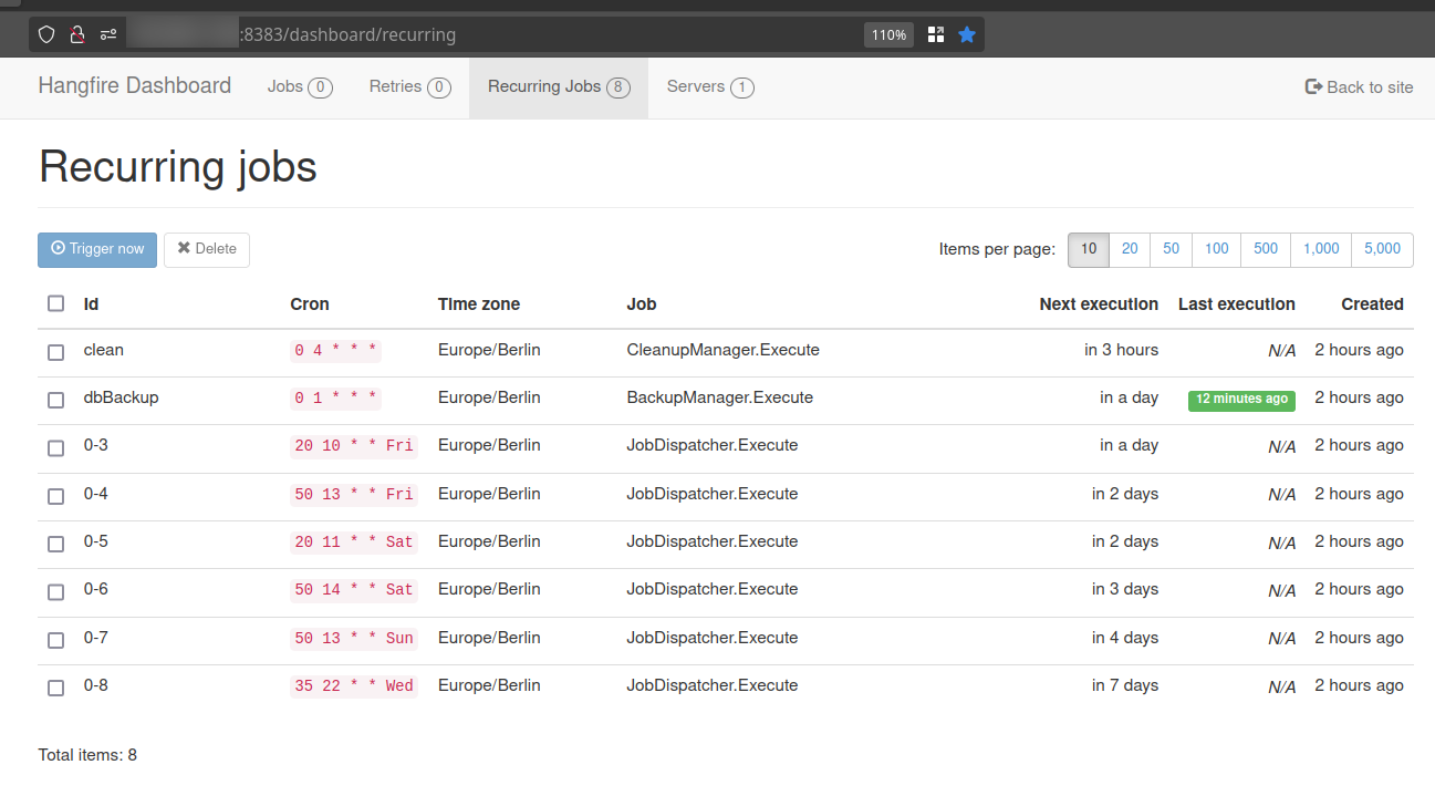

  4. Thanks for your help! 1. I am in the UTC +1 timezone, so this works for me I believe. Whenever I specifically set the TZ env to Europe/Amsterdam for example, the time actually goes one hour to the past for me, which the set TZ Europe/Amsterdam is supposed to match UTC +1. 2. "-t 73800 is over 20Hrs of recording time.", Ohhh, I now see that "Duration" is not "End Time", I blindly assumed so and did not read. This was not my intention at all, of course. Thank you! That will very very likely resolve my problems, so sorry about that. Also, I will now set the quality to 128kbps again! 3. Hmm, not sure I know what causes that, these are my jobs: 4. Indeed, I did rename the log outputs, there are no parenthesis in the actual names however. 5. That sounds great, thank you! Again, the donation link is no longer working, I really do appreciate this software. (And support the sentiment of this becoming open source perchance one day!) I am running the Docker template for the community apps on Unraid yes. For my specific use case which requires a VPN for a specific internet radio I added two env vars: "https_proxy=http://192.168.1.10:8119" and "http_proxy=http://192.168.1.10:8119" And also mapped a host:container Path: /etc/localtime:/etc/localtime (read only) to make sure the time is in line with my Unraid host system. Appdata is stored on a cache drive, indeed. Edit: One bug report though, when I edit a scheduled job, the set image is unset when saving the edit, and I have to upload it again, which is annoying. But I do not think it is a huge issue, just a report. Edit 2: So, now that I learned how to read and understand that we can only enter a Start Time and a Duration (not an "End Time", which I expected) Can I ask for two feature requests? One is to have either/or an option to set an End Time specifically instead. The other is to be able to schedule a record job, one time, for a specific date on a specific time instead. Like a calendar/agenda planned recording. ...So not a specific day every week to record on that specific specific time, every time that day in every week occurs. I cannot plan my recordings in advance, for my specific use case that would make life so much easier. Edit 3: Ah turns out, while using curl (when installed in the docker container), from the docker container and running "curl -s ifconfig.io" does return the VPNs IP, but the internet radio feed/station I play does not connect through the VPN still, that is fairly strange. At least, the live feed plays as if it connects through my browser with my real IP. (I have not yet been able to check with a recorded job, I can verify this within an hour it is currently recording...) Edit 4: YESS!!! The recording worked perfectly, it recorded through my VPN setup! So when you select Live through the browser, it plays through the client browser, not through the docker, noted. So happy that this works! Edit 5: As a third feature request, in addition to "Edit 2": Can we make the #progress bar a little larger, it is really hard to precisely click on it to skip through the recording?
  5. This is the log around that time: I believe the "fail: Microsoft.AspNetCore.Diagnostics.ExceptionHandlerMiddleware[1]" error we see was me landing on a page of an old job/recording that I removed, so that route failed. The docker logs time is not in sync with the system or the docker container itself. (It currently matches with my unraid host when I run "date" in the bash/terminal) Edit: Will have another log for another attempt coming up in a couple of minutes. Edit 2: And here it is: The scheduled job did start perfectly fine, but does not stop at the scheduled time, it is still recording as we speak, should have stopped 15 minutes ago. Edit 3: The schedule log is also empty fwiw:
  6. Hmm, a scheduled job is still increasing in size every second and minute and is in /app/config/temp, but the job was supposed to end 10 minutes ago now, the time in the docker is correct. I selected continuous in the assumption that would make a single file for just the duration. (Instead of hourly which I assume would cut/split the recording over multiple 1 hour mp3 files) Is that correct or does continuous just never stop perhaps?
  7. Thanks! I see, the automatic recordings seem to work, but I need to tweak them a bit, thank you. Other than that, I meant having the docker access the internet/wan through the proxy/vpn. I need the radio station to be accessed from a certain country, or otherwise it does not work. I can access the application fine with my reverse proxy if I wanted to, but the Radio needs to be accessed through a Proxivy/VPN from like Germany or something. I was wondering if there was a way to set this up with this docker. Thank you so much again for this great tool! Edit: Adding the extra parameters to the Rradio container template like this: `--env http_proxy=http://<proxivy-ip>:<proxivy-port> --env https_proxy=http://<proxivy-ip>:<proxivy-port>` Seems to work wonders for me! Edit 2: Also now running `ntpdate -u pool.ntp.org` daily as an userscript on the unraid host machine, as the time was incorrect, regardless of the date time settings and telling it to sync with pool.ntp.org through the WebGUI. Now the time adjusted at the Rradio docker, but went an hour to the past for me, so I removed the TZ env altogether and it just takes the host system time for me now, which is perfect. If that does not work, I believe you could also do this otherwise: volume mount host /etc/localtime to container /etc/localtime as read only Edit 3: The donation link is not working @PeteL

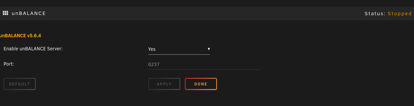

  11. I have the plugin installed, and seem to be unable to get the web gui started: Accessing the port number on the server ip regardless shows unbalanced is indeed not started. Is this a common occurrence, there are no new logs in /boot/logs/unbalanced.log to be found
