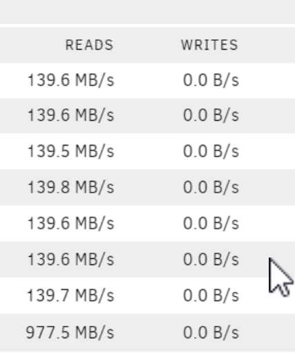

Kept VM running with 1660Super mining.
On VM stopped Burst mining for this test.
Top 2 lines are 2 Parity
Bottom line is total.
Tried with GPU & Burst mining stopped and get about same results but starts at 145MB/s(each HDD) from the PCIe 2.0 x16 operating at x4 slot with 9211-8i HBA card for those 7 drives.

11 minutes ago, Paul_Ber said:
I guess I could also try the speed test on individual drives.
There's a Docker container for doing that. You'll see that typical hard disks start off fast at the outer cyclinders and slow down considerably as they reach the inner cylinders. I have no idea what disks you have so I don't know if you're expecting faster than 140 MB/s, but it should be fairly clear that the PCIe connection is not the bottleneck. Unless both slots are connected via the chipset, they don't share bandwidth to the CPU and mining doesn't involve moving much data anyway - it's all about number crunching.
