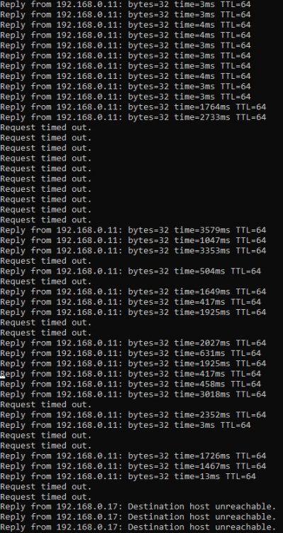

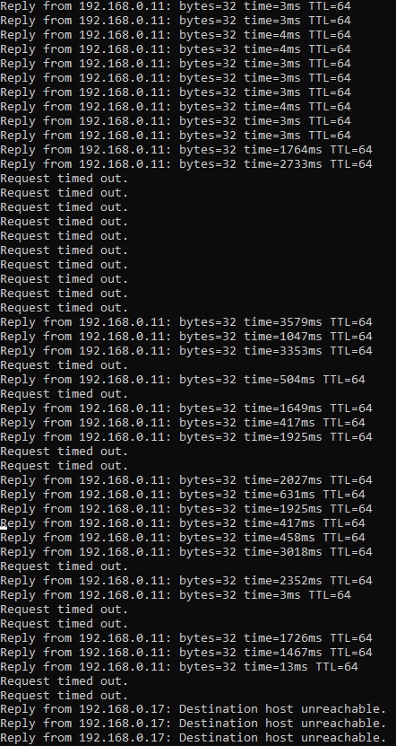

Once I start writing anything, things get wonky and crash. To observe this, I ran a continuous ping while rebooting the machine, starting the array, and moving files (attached screenshot). Constant steady 3 to 4 ms response time, then once I start moving files, it continued getting 3-4ms response times for about one minute, then times out, then comes back but decelerates into the 1000-3000ms response times, then becomes completely unreachable/locked up, only fixable via a hard power cycle.
