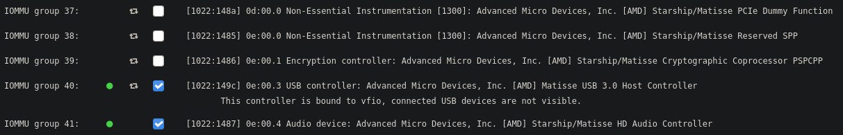

When I start a VM, it works fine but triggers this error. I think it's due to onboard audio pass-through. The actual error is:
2021-05-27T10:30:24.611787Z qemu-system-x86_64: vfio: Cannot reset device 0000:0e:00.4, depends on group 38 which is not owned.
Here are my IOMMU groups:
I was wondering, what would happen if I pass-through group 38 (Starship/Matisse Reserved SPP)?
I tried finding out what it was but it's not documented (or at least I didn't find anything useful).
