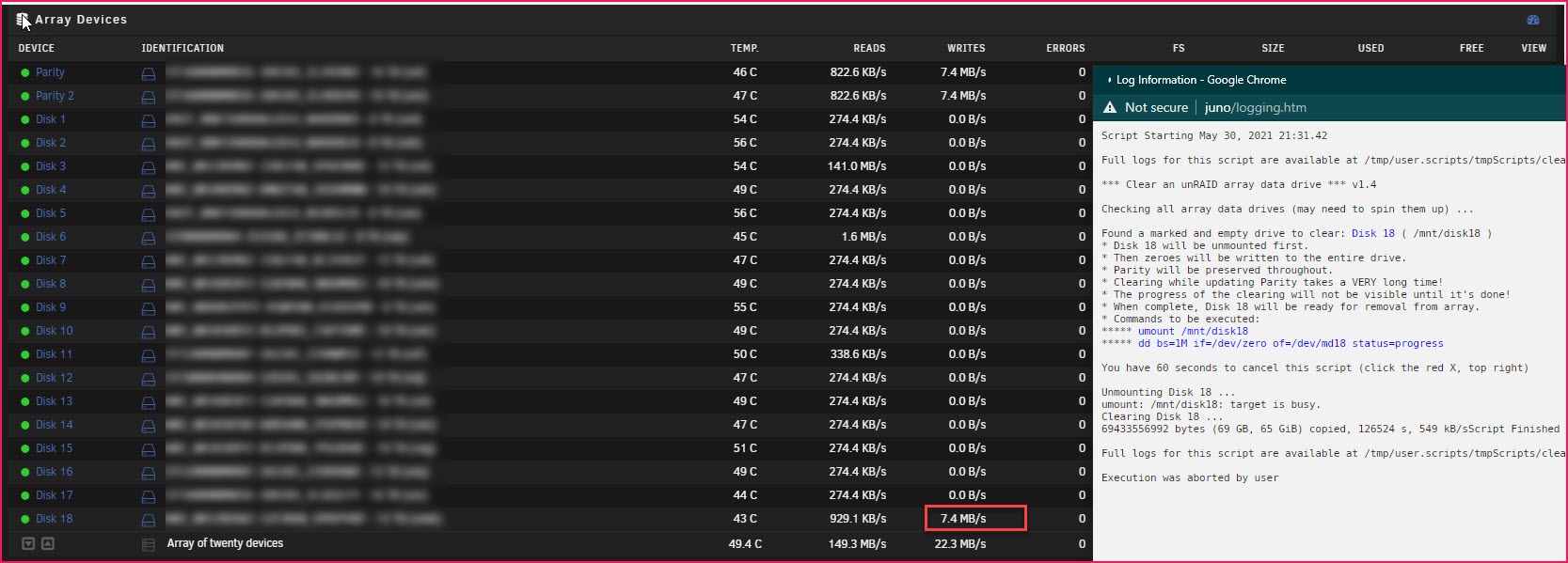

So after a day and a half of running the above script (array disk clearing) I calculated how long it will take, and it's more than a month, so I aborted it.
Thing is the "WRITES" column in MAIN screen show that it's still active. Nothing access the drive and it's still empty.
No "Abort" button for the script anymore.

So apparently "if the script called a long running command at the time of abort (something like find) then that command will run to completion."
Can I kill this script? How do I identify the relevant process?
