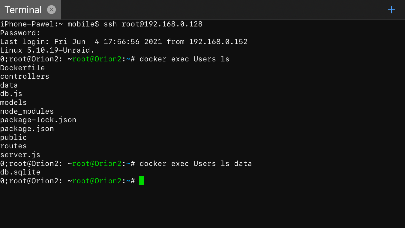

Yesterday I started learning Docker for development purposes. I created simple app with Node.js server and SQLite database on backend and React on frontend.
App is creating db.sqlite file in /data directory which I wanted to mount to access the file. However when I open directory on host side, the file is not there. I've been working on it for the last 4 hours and can't figure out what I'm doing wrong.
Here is mu Dockerfile. Right now I'm building React app manually.

I'm then starting the container with:
docker run --name app -p 5030:5000 -v /mnt/user/appdata/users:/data username/usersapp
When container is running and I console into it I can run ls /data and I can see the database file being there but it's not in the /mnt/user/appdata/users
Is there something fundamentally wrong I'm doing here?

According to your screen shots the ‘data’ folder inside the container  is not relative to the / folder inside the container but in a folder relative to a home folder, but the Docker run command IS mapping it at the host level to be relative to /.    That will be why you are seeing what you describe.
After changing it from :/data to :/app/data it’s working now. I read through all these articles and code examples and I was sure all the mappings were relative to the WORKDIR.
