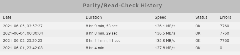

Installed latest version on HP N36L that's previously been running OMV for years solidly (so hardware should be fine), but for the past three days the server crashes with hard drive LED permanently on & no IP allocated on router.
Connecting to monitor, not responsive - nothing shown.  Didn't respond to ctrl+alt+del so had to hard power down the unit.  Upon reboot it starts a parity/read check which shows 7760 errors (assume this was form the hard power down as none shown before).  After last crash I run the memtest but no issues found.
