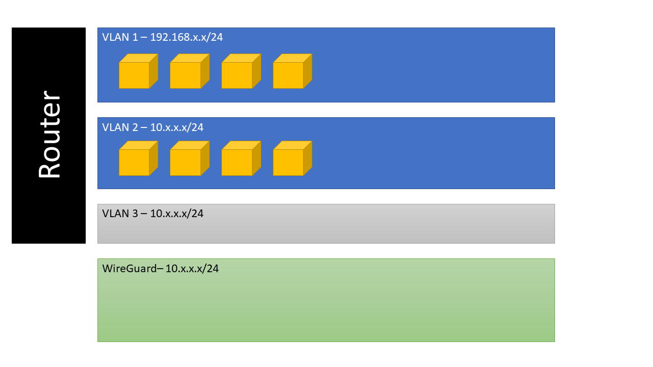

I have in the past had OpenVPN setup to access my LAN remotely and that worked OK but I have been looking at using WireGuard but I can't quite figure out the best way to set this up.
My network is setup across three VLANs with some of the docker containers running on Unraid assigned macvlan addresses on the different VLANs.  I want to have some fine grain control over what can be accessed over the VPN but I am not sure where the routing takes place in this setup.
I have tried various settings and I am able to access the Unraid server frontend but I can't seem to figure out to access things and lock this down to specific IP / ports.   In reality I mainly want to give access to some servers on VLAN 2 but the Unraid box doesn't actually have an address on this VLAN (the docler containers are running as macvlan as I only have one NIC) but it would be nice if I was also able to access some boxes on VLAN 1
Currently this is setup as "Remote Access to LAN" and I have setup a static route for the VPN network to the Unraid server IP and this gives me access to everything on one VLAN but I can't seem to get anything else to work.
Anyone got anything similar working?

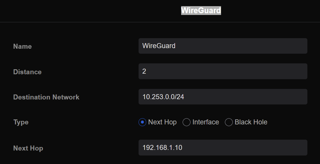

Did you setup a static route between WireGuard and IP address of unRAID server?  IIRC, I had to do this to access Docker containers I had assigned to my VLAN (br0.3).
My static route looks like this (destination network is the WireGuard LAN and Next Hop is my unRAID server IP address:
Here is a tutorial I put together of everything I did to make all my host/bridge and custom network containers on a VLAN accessible via WireGuard.  Perhaps something there may be of use to you.
WOW! That fixed it! I also set  “Local Server Uses NAT” to “No” in the Wireguard VPN settings.
I don't understand why this fixed it, though. I previously had Wireguard installed in Docker on a raspberry pi and I never had to set up a static route on my router to be able to access all networks. Not sure if you have any more time but I would love to understand what the static route did to make this work and why it wasn't needed for my previous setup.
Thank you!!!
