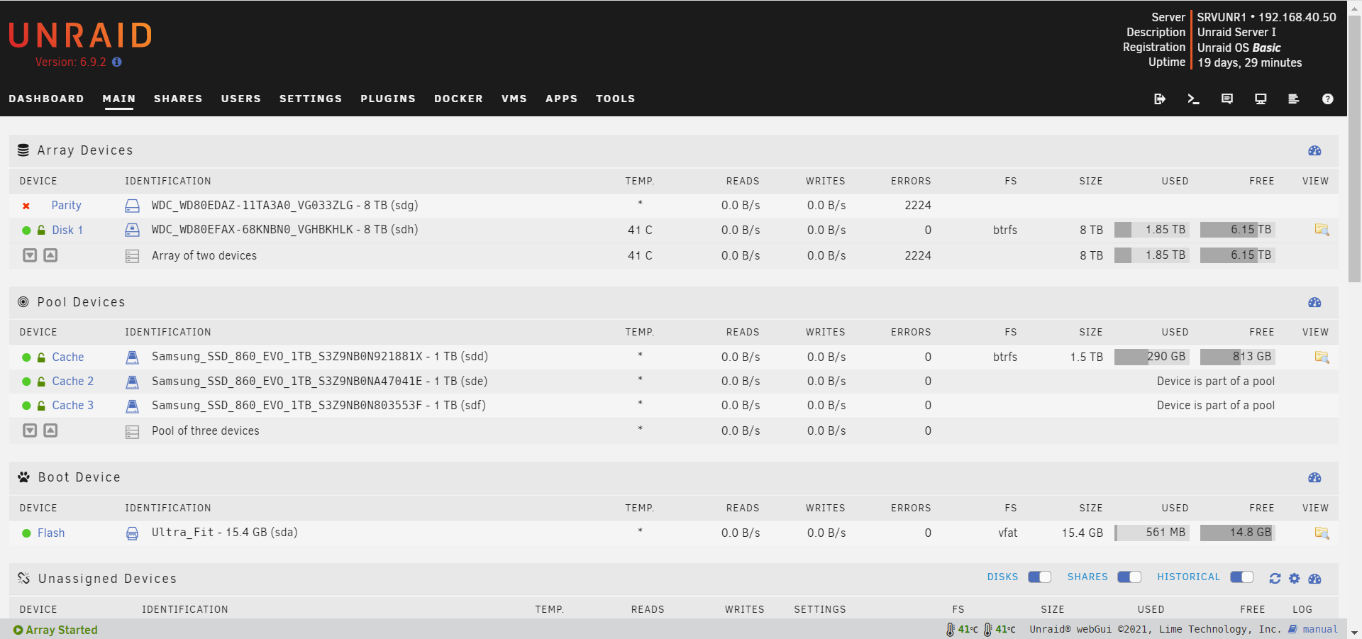

The issue:
One of the two disks in the array are randomly going to "error state" which results in a crash of all VMs on the server. It happens ~once per month. I checked the disks and they are totally fine. They are about 10 months old and i replaced one of them last month (just to make sure that the issue is not caused by a broken disk). I also swapped the SATA cables and the location in the server backplane. The last time the error occurred was at the 01.06.2021, 14 hours and 2 minutes after a parity check started. And the "failed" disk was the new/replaced disk.
Event: Unraid Parity disk error
Subject: Alert [SRVUNR1] - Parity disk in error state (disk dsbl)
Description: WDC_WD80EDAZ-11TA3A0_VG033ZLG (sdg)
Importance: alert

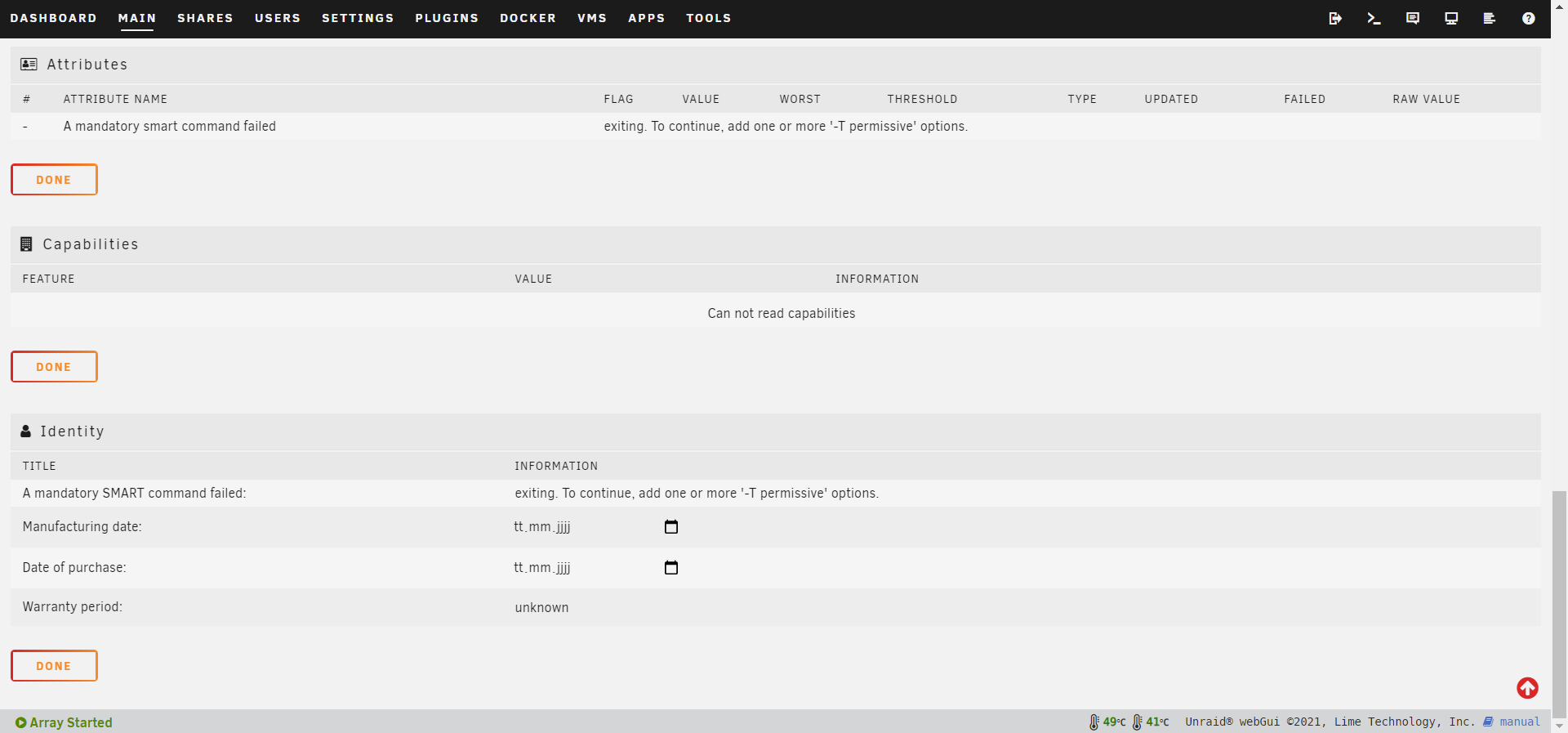

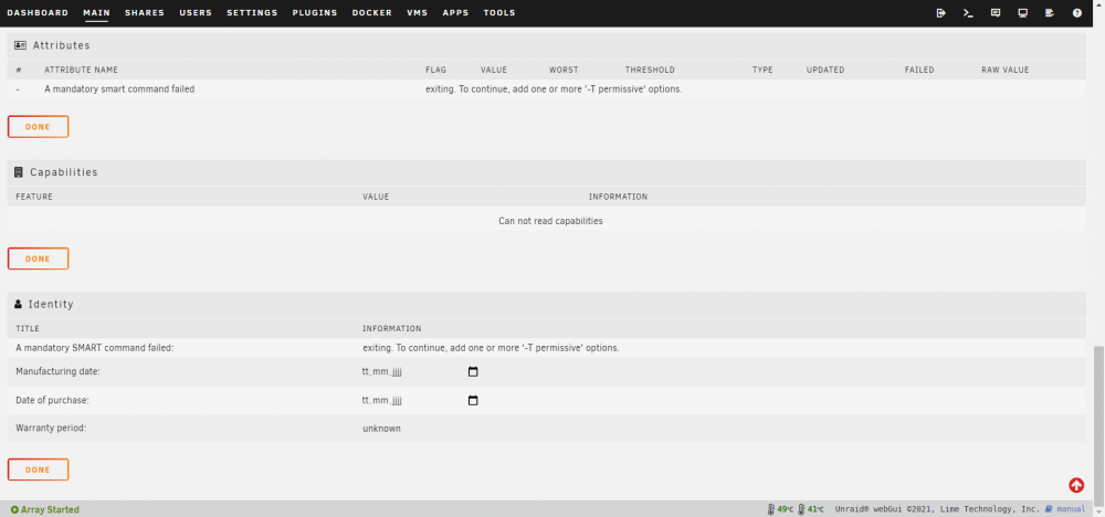

I added some screenshots from the GUI after the crash and the diagnostics. To get the system back up running i have to:
#1 Reboot the system
#2 Remove the "error state" disk
#3 Start the array
#4 Stop the array
#5 Add the disk
#6 Start a parity rebuild/resync depending on the disk that got corrupted (parity disk/data disk)
How can i stop this from happening?
