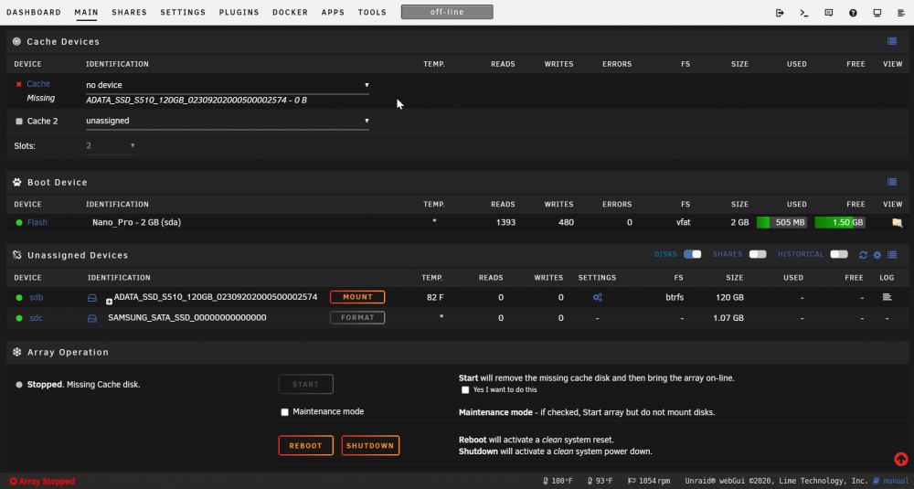

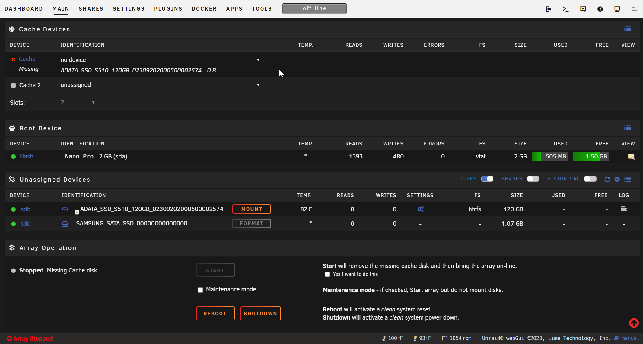

When I try to remove the one remaining drive from the pool, I get the Missing Disk error and the Start button is greyed out: image.thumb.png.77f2d1c62fbc48240308c2dd6ef7d6a9.png

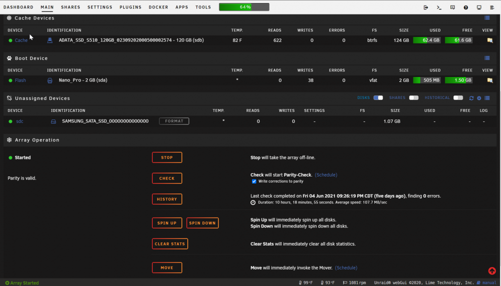

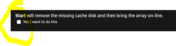

An interesting thing is that the Unassigned Device is showing as 1.07GB in size. This is a 128GB SSD drive. My cache pool included a 120GB and 128GB to create a pool size of 124GB.
The cache pool is still showing size of 124GB even though the second disk in the pool is missing. Is this correct?
It's still mounting the pool (including the unassigned device), since it's available.
