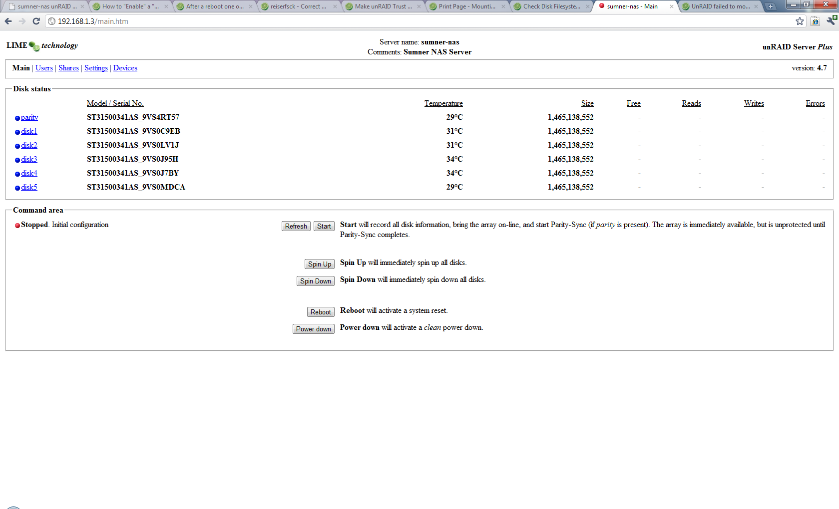

Yes, I got the system to reboot fine, not sure what was causing the problem.  The bad news is that disk4 /dev/md4 still refuses to mount.  As I stated before I ran SeaTools on it short test and it passed.  I also make sure all my cables and controller are tightly connected.  And disk4 was detected by the unraid computer it just can't mount the volume!  I'm going to run the long test overnight on disk4 and see if it reports any problems.
I attached a zip file which contains screenshots within UnRAID interface of the problem.  Screenshot of my device options before and after I swapped my parity drive.  I included output of the smart test I ran on the drive.  I included output of my attempt to run reiserfsck which failed.  I included my syslog from my last reboot.

My original parity drive is not usable.  So I need to figure out how to recover the data on that drive.  I do have an extra drive to copy data too, just don't know the steps I need to follow.
So overnight I ran badblock and long smarttest and both completed with no errors!  To troubleshoot further I moved the disk to another controller.  I then went into UnRAID and assigned the drive back to disk4.  Now unraid is telling me its a new disk and giving me the option:
Start will bring the array on-line, start Data-Rebuild, and then expand the file system (if possible).
I definetely know the my parity disk is not good so if I start Data-Rebuild I'm guessing I lose all the data on this disk for sure.  Not sure what to do from here.
I move the disk associated with /dev/md4 to another SATA controller and assigned it as disk4 in UnRAID.  Now unraid is telling me its a new disk and giving me the option:
Now sure what to do now.
