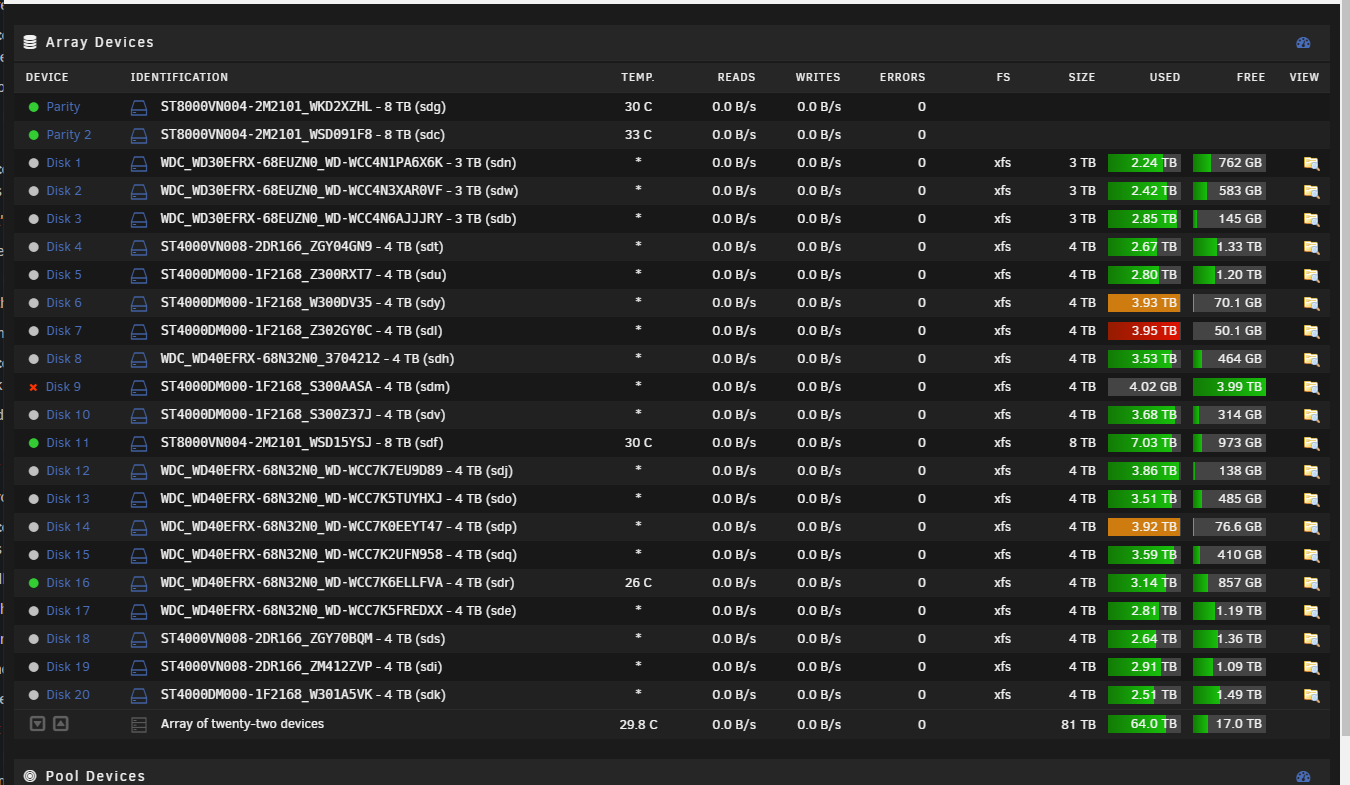

I remember reading somewhere that if you remove all the data from a Data Drive and remove it from the array. you don't need to rebuild the array.
How do you do that? can you do that? my disk9 has failed so i've pulled all the Data off it and want to remove it from the array as a Data Drive i don't want to replace it.
Upgrading to 8TB drives so collapsing how many disks are in my array.
I just can't work out how to pull the disk without a rebuild being needed?
