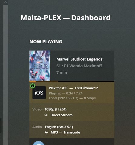

I would assume that these devices (XBox and Fire) are on the same LAN as your Unraid server?  They should likely play Direct Stream (where the playback device decodes them) rather than Plex transcoding the video.  You can see if this is what is taking place by going to Settings > Dashboard while playing an offending file on the XBox/Fire (see screenshot).
I would check the settings on all of the devices (and server) if it is transcoding.  The Fire Stick 4K should handle just about any 1080p format (including h.265), the XBox One, being a bit older likely doesn't support some of the newer/higher end encodings.
