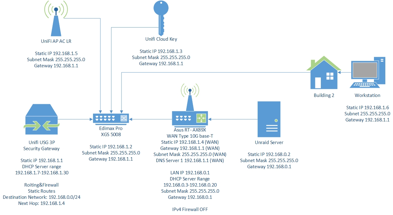

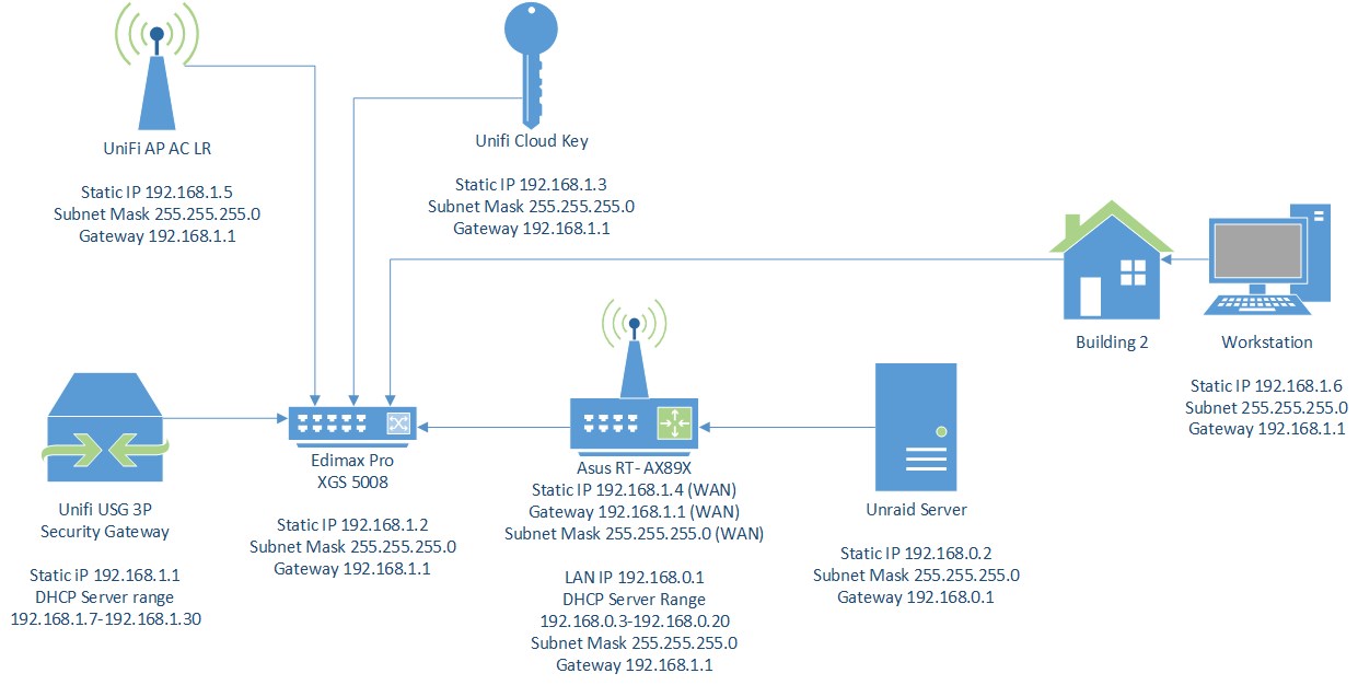

i recently changed my switch,  router and unpaid server to 10gbe since I can’t reach the server from the workstation in building 2. The wan port on the AX89x is set to 10gbe lan. I’m not an network expert but had it somehow running like that before with net gear switch and an r7000 ddwrt
AX89x Port forward
Source          Destination     Proto. Port range  Redirect to     Local port
ALL             ALL             TCP    8443        192.168.0.1     8443
ALL             ALL             TCP    445         192.168.0.2     445
ALL             ALL             UDP    137         192.168.0.2     137
ALL             ALL             UDP    138         192.168.0.2     138
ALL             ALL             TCP    139         192.168.0.2     139
ALL             ALL             UDP    139         192.168.0.2     139
what do I miss here?

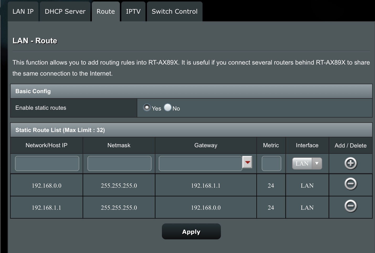

I'm not familiar with your Asus router, but did you configure static routes on each of those router into the other network?

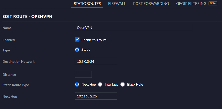

Attached a screenshot with a static route configuration of my USG-3P.
Otherwise the devices in your subnet won't know how to reach the other subnet via which router/interface/ip-address.
On your USG-3P the destination network would be "192.168.0.0/24" and the next hop "192.168.1.4"

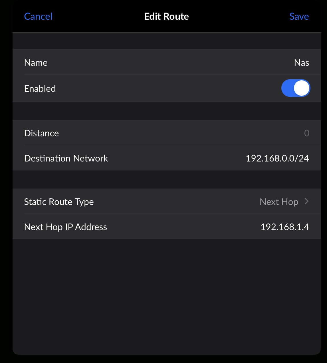

Thanks, now I put static rout in the Usg still no success. I also tried many combinations in the ASUS just nothing works. Do I’ve to do portforward on the usg as well?
You would need some device to be running a valid gateway on the 192.168.1.x subnet to be able to route between them.
Thanks for the help I got it working like that (mostly)
