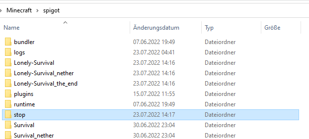

My son should be able to start/stop a Minecraft container without getting access to the Unraid GUI. And to save some electricity costs, the container should even automatically stop if it's not used anymore.
At first I added through the SMB (extra) settings a new SMB Share as follows (replace "max,moritz" against your usernames):
[Minecraft-Server]
	path = /mnt/user/appdata/Minecraft-Server
	comment =
	browseable = yes
	# Private
	writeable = no
	read list =
	write list = max,moritz
	valid users =  max,moritz
	case sensitive = auto
	preserve case = yes
	short preserve case = yes
This gives my son access to the Minecraft appdata subdirectory, where he is able to create a dir called "stop" to stop the container or he deletes it, which automatically starts the container:
