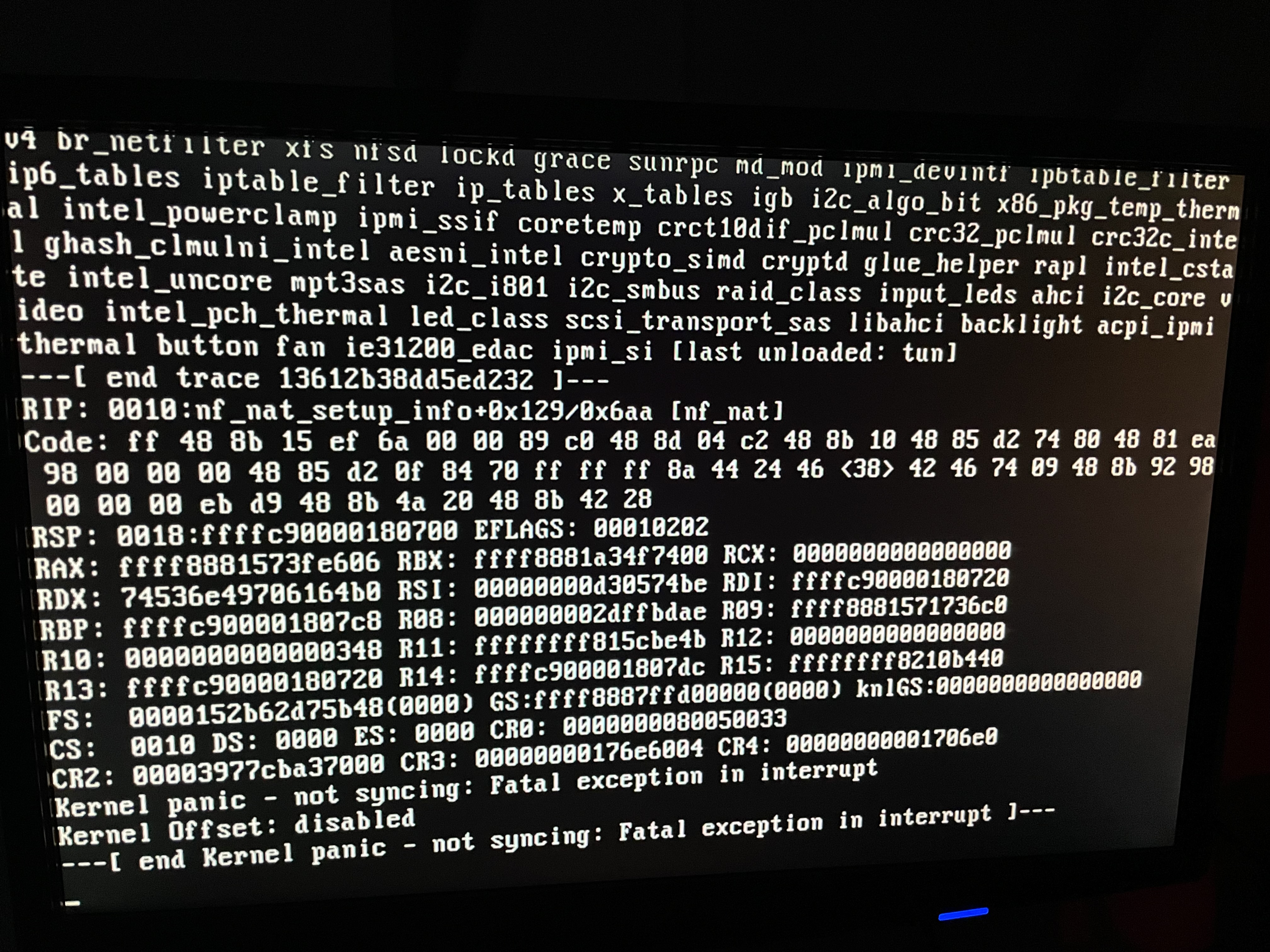

Kernel panic - not syncing: Fatal exception in interrupt

I've been trying to figure out why my server has been randomly crashing ever since a power outage last week. My UPS didn't stay online long enough for the server to power down gracefully. It's been super intermittent on when it happens. When it first occurred, it lost one of my cache drives. I was able to add it back and scan everything and there were no errors. I did have to run `xfs_repair` on a couple of drives in the array which fixed the error reported in the unRAID GUI.
I started recording the syslog and the one below is the last one running when the server crashed this morning around 5AM. I only included the lines that were within an hour of the crash. Memtest passed as well.
