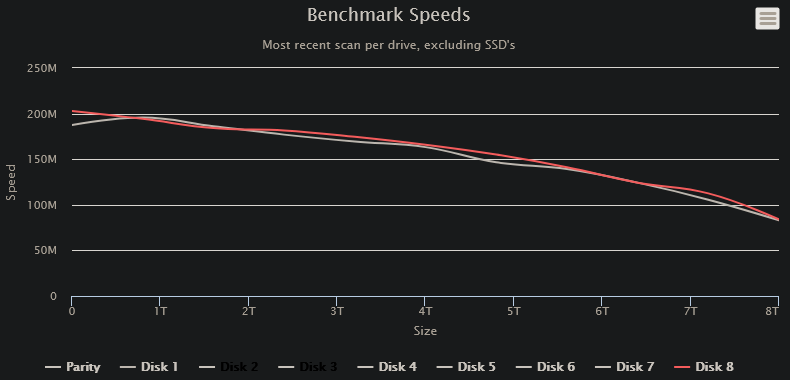

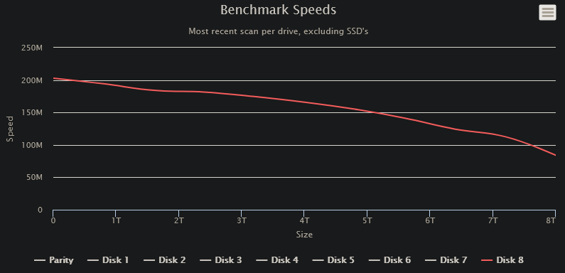

Diskspeed shows that it's not entirely unreasonable in terms of read speed
And, it's on par with Disk1 which is the other Barracuda drive I've got
Unfortunately, that's only read speed being tested, not write speed. I've not specifically noticed issues with writing to Disk1, but this is really the first time I've tied some of the system issues I've had to writing to a specific disk, so I'm not sure if Disk1 is contributing to the general slowness I'm having.
