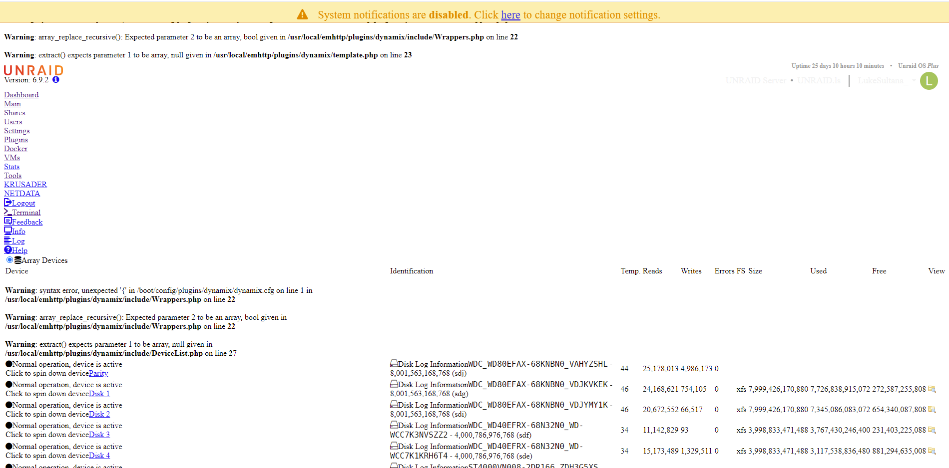

I've currently got the following Unraid GUI issue:
I've had the issue once before. A restart fixed it the last time. However, I'd prefer to actually know what is causing it. My syslog basically gives direct information to how to access my server remotely. So I won't post that.
Any chance anyone has seen this issue, or has any relevant information on how to tackle the troubleshooting of this? Thank-you in advance.

It isn't browser related. Multiple devices, multiple browsers, same issue.

Syslog shows that multiple webgui resources are failing when sending to the client (client = shows the remote access link and port). This is where I am accessing it, I'm not concerned about being hacked. I'm concerned about my WebGUI, which is why I asked for help with that.

Corrupt flash. Do you have a backup? Put in PC and checkdisk. While there make a backup if you don't have one.

I can pull backup from MyServers. Thanks for the help. I will get this sorted. Thanks mate.
